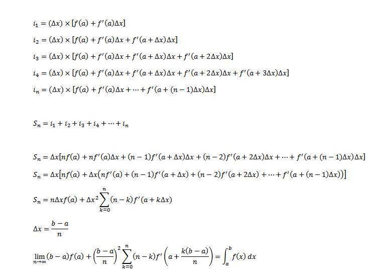

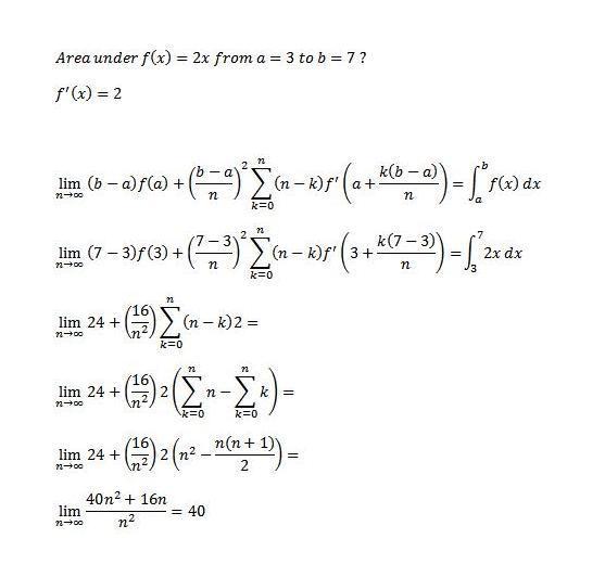

I think i discovered a new way to define an integral, i don't know if it helps in any particular case, but its an idea worth posting i think.
The idea is to define the height of the rectangles based on one single point of the function and then build up the next heights for the other rectangles from the dx of the function.
Im a student of engineering in my first year, so i don't have a very rigorous math based way to show my ideas.
I attached two pictures showing the idea and an example
I tested it on regular functions and it works fine, the idea is to integrate a function from its derivative, maybe this could work for functions whose derivative is easier to calculate right?

At first glance, I can't really tell if this is a good definition or not. Have you tried some functions that are not linear? e^x, or 1/x or x^2?
i tried with functions such as x^2 and x^3 and it works perfectly, i don't know how to attack sums involving e^k or 1/n. But the idea is solid, i tried it for definite and indefinite integral and its working. I tried to integrate f(x)=ln(x) using its derivative but i i can't get past the 1/n sum.
Yes, it works. But it is basically the same as doing integration by parts. You have basically just written out a kind of integration by parts in its limit definition. Notice that
[tex](b-a)f(a) + \left(\frac{b-a}{n}\right)^2 \sum_{k=0}^n (n-k)f^\prime\left(a + k\frac{b-a}{n}\right)[/tex]
[tex] = (b-a)f(a) + b \sum_{k=0}^n f^\prime\left(a + k\frac{b-a}{n}\right) \frac{b-a}{n} - \sum_{k=0}^n \left(a + k\frac{b-a}{n}\right) f^\prime\left(a + k\frac{b-a}{n}\right) \frac{b-a}{n}[/tex]
So by taking limits we get
[tex](b-a)f(a) + b\int_a^b f^\prime(x)dx - \int_a^b xf^\prime(x)dx[/tex]
[tex] = (b-a)f(a) + b(f(b) - f(a)) - \int_a^b xf^\prime(x)dx[/tex]
[tex] = bf(b) - af(a) - \int_a^b xf^\prime(x)dx[/tex]
Evaluating the integral by parts gives us
[tex] = bf(b) - af(a) - [bf(b) - af(a)] + \int_a^b f(x)dx[/tex]
[tex] =\int_a^b f(x)dx[/tex]
which is exactly what we want.
