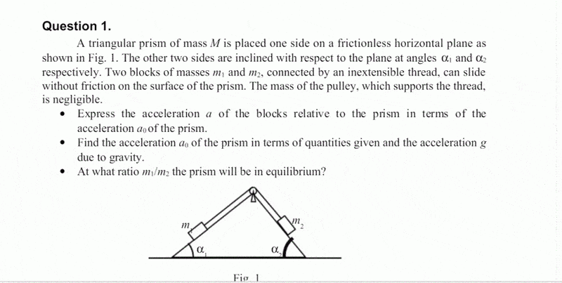

Question 1.
A triangular prism of mass M is placed one side on a frictionless horizontal plane as shown in Fig. 1. The other two sides are inclined with respect to the plane at angles a1 and
a2 respectively. Two blocks of masses m1 and m2, connected by an inextensible thread, can slide without friction on the surface of the prism. The mass of the pulley, which supports the thread, is negligible.
  • Express the acceleration a of the blocks relative to the prism in terms of the acceleration a0 of the prism.
  • Find the acceleration a0 of the prism in terms of quantities given and the acceleration g due to gravity.
  • At what ratio m1/m2 the prism will be in equilibrium?

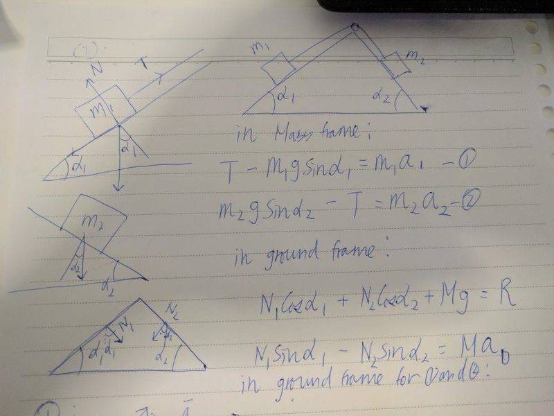

ma=F
see the picture below
i got totally wrong as it is too hard
can everyone give me hint to do this question
How did i do this question in a more clear and systematic way?

I think you assumed that the blocks are not accellerating in the directions perpendicular to the inclined surfaces of the prism, which of cause not true.
Likes tze liu
But how to do this question thank
The blocks on the inclines are sharing the horizontal acceleration of the prism since they are moving with it.

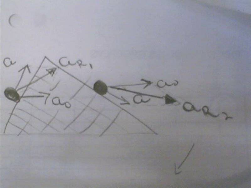

seems i forget to use consider the inertial force in this case??

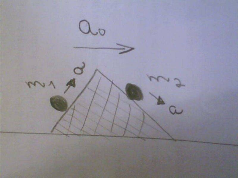

The accelerations of the blocks along the incline are the same, say a , since they are connected with a string.
They are also accelerating horizontally, ao , so I am not convinced it is business like usual :sorry:
only along the inclines we have a

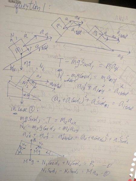

Did I do something wrong in these several steps thank

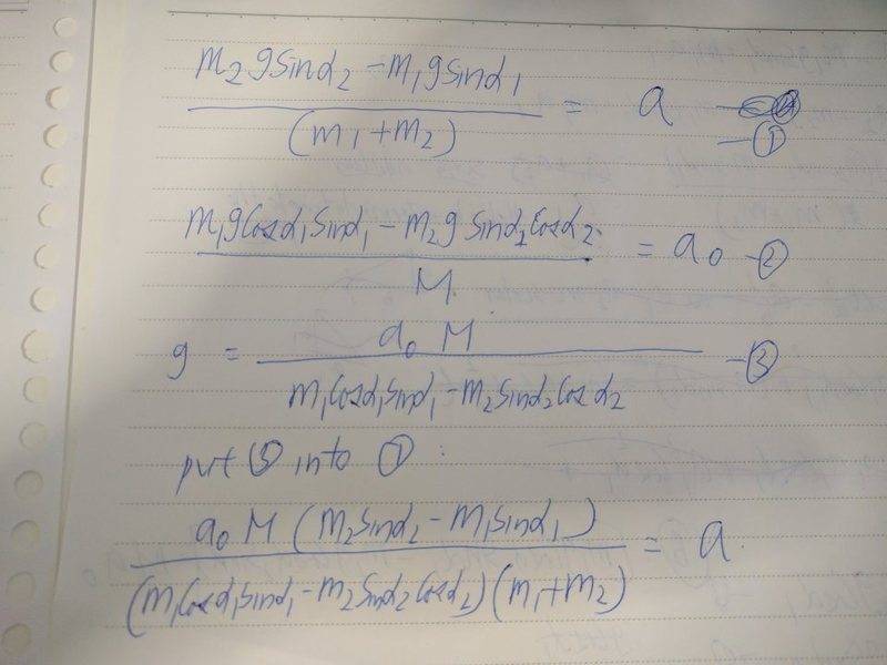

Can u use high school method to do it how about my work done here?

The a1x and the a2x are the same for starters, but I am not convinced this way of approaching it will work (or is the easiest), although I might be wrong.
What i would rather suggest is analyzing the forces along the inclines, as you did, and use just a symbol a for the acceleration along the inclines for both masses, that is your x-direction equations.
The other sets of equations is for all three objects in the horizontal direction, with an acceleration ao in all three equations.
This approach I guess would be more promising, also it directly uses the symbols suggested in the original question.

i cannot solve it
no idea
as i expand such equations ,it seems that it make it too complicated
Consider which forces are causing the prism to move, and which forces are causing the blocks to move. Remember the blocks move with the resultant acceleration of a and a0.

Please do not post handwritten working as images. Not only are they usually quite hard to read, and frequently sideways or upside down, it also makes it hard to comment on individual steps. Images are for diagrams and textbook extracts.
Suppose the left hand block is accelerating down the slope at rate a relative to the prism. What is the horizontal component of that? If the prism is accelerating to the right at rate a0, what is the net horizontal acceleration of the block?
What net horizontal force must be acting on the block?
Do the same for the right-hand block. What force balance equation does that allow you to write?

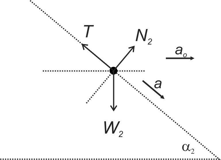

The acceleration of both blocks along the incline is a, say 1 up and 2 down. So develop such equations just like before, just with the acceleration indicated as a for both.
Then for each block you also resolve the forces horizontally. The acceleration of the blocks is ao, let's say horizontally to the right, that is while the blocks are sliding they are moving together with the prism, all accelerating to the right with acceleration ao. This will give you 2 more equations.
Finally one more equation for the prism, since it is also accelerating horizontally to the right at ao.
That gives you 5 equations in total.
Your x-equations are correct, say for 2
m2 g sin(α2) - T = m2a
but the block is also accelerating horizontally ao
so add up the horizontal components of the forces on the block and they should produce the ao acceleration
