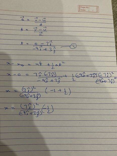

From the origin, a particle starts at t=0 with a velocity v vector= 7i^ m/s and moves in xy plane with constant a= -9i^+3j^ m/s2. At the time the particle reaches the max x coordinate, what is its a)velocity and b)position vector?
a=(v-u)/t
s=ut+1/2at^2
I have attempted but I don’t get anywhere.

Start by thinking about motion in the x-direction only (ignore the y-motion).
At t=0, x=0. Initial x-velocity is ##u_x## = 7m/s, and x-acceleration ##a_x## = -9m/s².
If the maximum x-coordinate reached is X then:
I) What is the x-velocity when x=X?
2) What is the time at which x=X?
3) What is the value of X?
If you can answer these, you can go onto the y-motion.

I see that in your attempted solution, you are using vector, u, for the initial velocity rather than using v as in the given problem statement. That's fine as long you are consistent, although it's good practice for you to point that out.
I see that @Steve4Physics has just replied, so I will cut this short.
You might want to write your first "Relevant Equation" in a different form.
##\vec{v}(t)=\vec{u}+\vec{a}\ t ##
Also,
In general, vector division is an undefined operation.

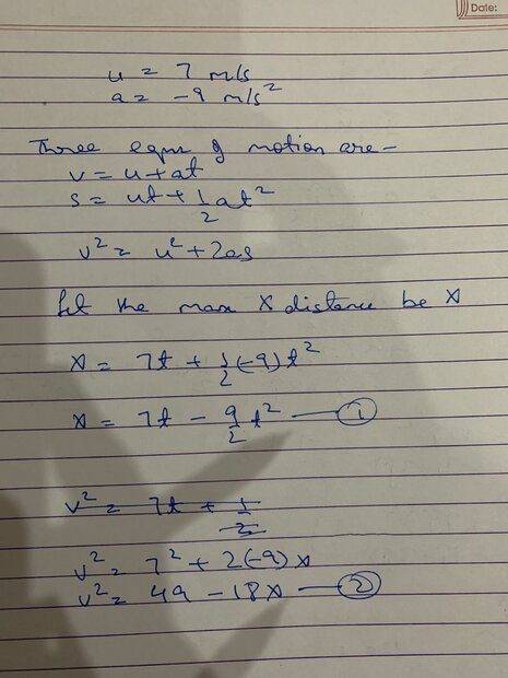

rudransh verma said:
Now what?
The working in your attachment is correct but you haven't spotted they key point.
Try again, answering Q1 only:
1) What is the x-velocity when x=X?​
No calculations or equations are needed! Can you answer - and explain your answer?
Hint: Imagine you are watching the process happening:
- an object is moving to the right with velocity 7m/s;
- a negative force (i.e. acting to the left) is applied, giving the object an acceleration to the left (i.e. a negative value of acceleration because F=ma).
How would you describe, in words, what happens to the object’s position and velocity? No calculations or equations are allowed!
It came to me and if I am right the velocity should be zero.
Likes Steve4Physics
Yes! Another example is throwing a ball up. Initial velocity is positve, acceleration negative. The ball's speed decreases while rising, is zero at the highest point and increases as the ball comes back down.
Have a go at the rest of your question.

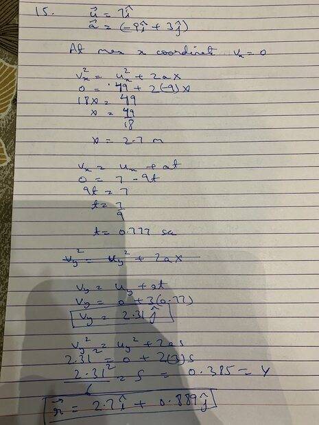

@Steve4Physics But I have the answer and its not zero.
But you haven't worked out the y-velocity yet!
I have got the max x coordinate 2.7 m by v^2=u^2… But when I calculated the time t using s=ut+… I am getting two values .84 and .7 (quadratic).
Is the body moving in horizontal plane or vertical?
The unrounded value is X=2.7222...m. Make sure you use the unrounded value in any calculations or you will introduce (possibly large) rounding errors.
That's because you have (correctly) solved the incorrect equation, 4.5t² – 7t + 2.7 = 0. This has 2 solutions of approximately 0.848s and 0.706s.
You must solve (for example) 4.5t² – 7t + 2.7222222222222 = 0.
You will get two (almost) identical solutions. The two solutions will get closer to each other the more decimal places you use for X.
But a much better way to find t is to remember what you said in Post #7 and then use v = u + at.

I got it right .

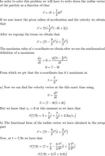

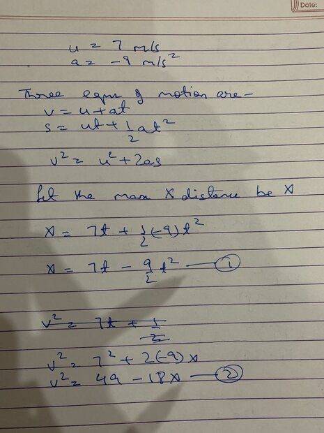

But there is another way to do it which I don’t understand completely. I have attached the image. Explain!
I got it right .
I hate trying to respond to pictures. So I've converted some of it to text and Latex and included it in line.
the second picture said:
In order to solve this problem we will have to write down the radius vector of the particle as a function of time$$\vec{r}=\vec{v}t + \frac{1}{2}\vec{a}t^2$$
I prefer calling it a position vector since "radius" strikes me as relating to a circle.
If we now insert the given values of acceleration and the velocity we obtain that$$\vec{r}=7t \hat{i}+\frac{1}{2}t^2(-9\hat{i}+3\hat{j})$$
After we regroup the terms we obtain that$$\vec{r}=(7t-\frac{9}{2}t^2)\hat{i} + \frac{3}{2}t^2\hat{j}$$
The maximum value of x coordinate we obtain after we use the mathematical definition of a maximum
The author is writing poorly. This is not the mathematical definition of a maximum. Instead, we are about to use one of the proven properties of a maximum of a function: A maximum must occur at an endpoint, at a discontinuity of some sort or at a point where the first derivative is zero. In this case we have no discontinuities or endpoints, so it will be at a point where the first derivative is zero. We will proceed to solve for the value of ##t## where the function derivative is zero.
$$\frac{dx}{dt} = 0 = \frac{d(7t-\frac{9}{2}t^2)}{dt}$$ $$0 = 7 - 9t$$
From which we get that the x coordinate has its maximum at$$t=\frac{7}{9} \text{s}$$
Does this help at all?
