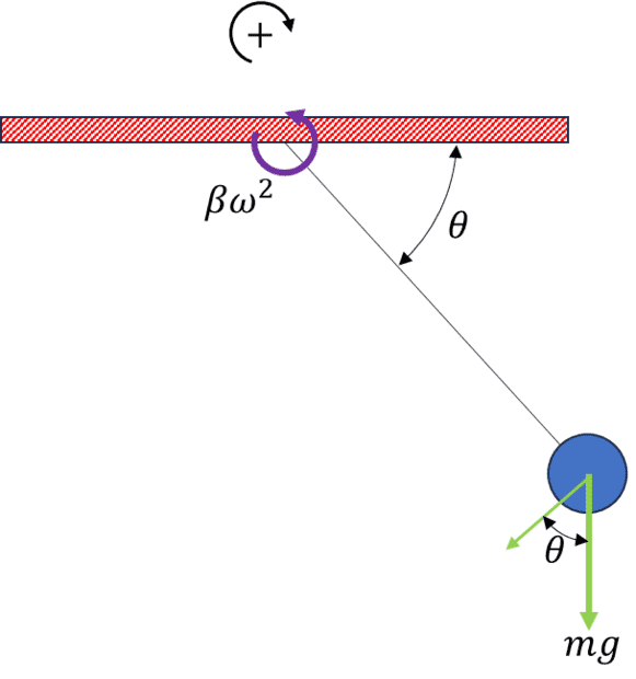

Consider the standard pendulum with a weightless rod of length b and a mass point m and mg is applied. In the hinge there is a torque of viscous friction which is proportional ##\omega^2##.
Now release the pendulum from the horizontal position. What biggest height does the point m attain after its first passing through the vertical position?
Let me know whether I got you. Is the equation of motion
L=ml^2\dot{\theta}
\dot{L}=ml^2\ddot{\theta}=-mgl\sin\theta-k\dot{\theta}^2 sgn\ \dot{\theta}?
I get the following eq of motion:
$$ mb^2 \ddot \theta + \beta \dot \theta^2 - mg b \cos \theta = 0 $$
You are saying this is analytically solvable?
Yes,
$$\dot \theta=\omega(\theta),\quad mb^2\omega'\omega+\beta\omega^2-mgb\cos\theta=0$$
and $$\omega'\omega=\frac{1}{2}\frac{d}{d\theta}\omega^2$$
a linear equation with respect to ##\omega^2(\theta)##

$$ mb^2 \frac{d \omega}{dt} + \beta \omega^2 - mgb \cos \theta = 0 $$
$$ mb^2 \frac{d \omega}{d \theta} \frac{d \theta}{ dt} + \beta \omega^2 - mgb \cos \theta = 0$$
$$ mb^2 \frac{d \omega}{d \theta} \omega + \beta \omega^2 - mgb \cos \theta = 0 $$
While it is true that
$$ u = \omega^2 $$
$$ \implies \frac{du}{d \theta} = 2 \omega \frac{d \omega}{d \theta} $$
would convert that to a linear equation, it is not true that ##u =\omega^2## is a viable substitution given the non-constant term ## mgb \cos \theta## that remains in the equation.

Introduce a notation ##y(\theta)=\omega^2(\theta)## then the equation from 3
takes the form $$mb^2y'/2+\beta y=mgb\cos\theta.$$
To solve it use the method of variation of a constant
https://personal.math.vt.edu/renardym/class_home/firstorder/node1.html
EoM=equation of motion, and I think the correct equation of motion, with ##\theta## counted relative to the direction of ##\vec{g}## is
$$mb^2 \ddot{\theta} + k \dot{\theta}^2 \text{sign} \dot{\theta} + \frac{m g b} \sin \theta.$$
