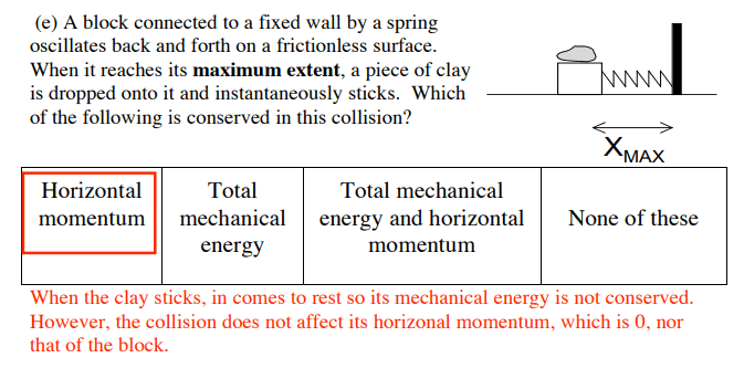

A quiz question
##E_i=E_f##
I don't get why the total mechanical energy is not conserved in this situation.
When the length of the spring reaches the maximum, the speed of the block is 0 and we have the following equation:
$$E=K+U=1/2mv^2+1/2kA^2,\text{where A is the amplitude} \implies E=1/2kx_{max}^2$$
I can't see why the amount of energy changes. Could someone please explain the reason to me? Thanks a lot.
Leo Liu said:
I can't see why the energy changes.
Read it more carefully. It says the ME of the falling clay is lost.
Aha, I see--this is kinda tricky. Thank you.

I'm with you. No mention is made of the height of the drop...it could be made negligibly small in which case the problem is better. Badly stated problem by my reckoning.

I have my doubt about conservation of horizontal momentum because we have the force of the spring acting in the x- direction which is at a maximum value btw during the collision.
I think "none of these" is the ultimate correct answer after all but of course one may argue that the horizontal momentum is approximately conserved.

I don't see how it affects horizontal momentum. The block is stationary when the clay sticks to it. No horizontal momentum immediately before impact and none immediately after.

Isn't the spring force , via its impulse, going to transfer horizontal momentum ##\int_t^{t+\Delta t} kx(t) dt## during the impact time interval ##(t,t+\Delta t)##.
Yes, but in all such questions we take Δt to be arbitrarily small.

Btw, the question could be clearer. It doesn’t specify whether it's the horizontal momentum of the block or of the block+clay system. If the latter, it is unnecessary to assume the block is stationary for the duration of the impact.
Judging by the answer i think it means the horizontal momentum of the clay.
The answer given is that neither the clay nor the block change in momentum.
Given the question but not the answer, I would have guessed it was asking about the block.
