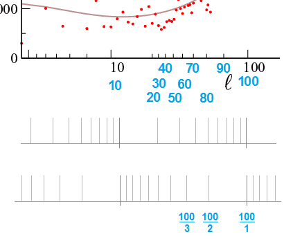

The minor tick marks on the bottom scale of Fig.14 look weird (the top scale appears fine and I think the bottom should match it).
Thanks for the comment. The axes are measuring different things that are inversely related; hence the difference in minor tick marks.

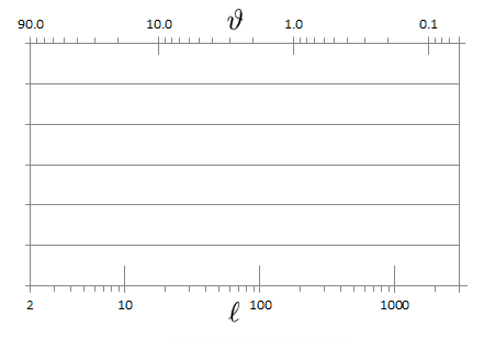

I'm assuming it's supposed to be a simple log scale, hence the distance between consecutive ticks should decrease as the values increase. The distance from 30 to 20 is much less that that from 10 to 20, but after that it increases, the distance from "90" to "100" is much larger than from "20" to "30". At a guess, the "20" looks right but the spacing of "30" to "90" seems mirror-imaged. I've marked up an image and included a roughly similar log scale from an Excel graph to illustrate what I mean. I may be mistaken but it just looks odd unless the ticks are not multiples of 10. I've also added a reversed scale if that's what was meant.
p.s. A reversed scale would mean the bottom minor tick marks are 11.11, 12.50, 14.29, 16.67, etc. but I didn't think that ##l## could have fractional values.
p.p.s [too late to edit the previous] The equation above the graph says ϑ=π/ℓ radians but the graph starts at (I think) ℓ=2 and ϑ=90 so seems to be in degrees which is fine but if the top ticks are then meant to be 80, 70, 60 degrees etc., I think they might be the wrong way round too.
OK, I see now. Yes, the axes are messed up. I'll go back and check what might have happened: I was having difficulty getting the two separate x-axes to look right...apparently I didn't succeed after all.
I tried to replicate your graph in Excel but I can't find a simple source of the data, Planck publishes it in FITS format and I don't have any easy way to read that on a basic PC without installing software and writing scripts. Anyway, assuming you use degrees and the highest ell is 2508 (based on the FITS description), I think the scales should look something like this for ℓ from 2 up to 3000 and ϑ=180/ℓ from 90 down to 0.06 degrees:
