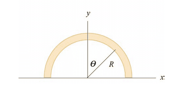

A positively charged wire is bent into a semicircle of radius R, as shown in the figure below.
The total charge on the semicircle is Q . However, the charge per unit length along the semicircle is non-uniform and given by λ=λocos(θ)
What is the relationship between λo, R and Q?
Q = ∫ λ ds
F = qE
Q = ∫ λ ds = ∫(from θ=0 to π) λocos(θ) dθ.
However, this yields evaluating the sin function from 0 to π which is just 0. I'm having a hard time believing that there is no relationship between λ, R, and Q. I was wondering if someone would be able to check my work.

It completely depends on where ##\theta = 0## is on the semicircle. Obviously, if it's on one end, Q = 0 because for a quarter of a circle the charge is the negative of the other. But, from your drawing, it seems you should actually use ##-\pi/2,\pi/2## as boundaries, which changes everything (the charge has the same sign throughout).

Look at θ as it is shown in the figure.
It looks like θ goes from -π/2 to π/2 .

According to the figure, Θ is measured from the y-axis (not the x-axis).

Oh, I understand what you're saying now!
So now that I have the proper limits
Q = ∫(from θ=-π/2 to π/2) λcos(θ) ds = 2λs = 2λr.
Is this now correct?

You need to express ds in terms of dθ in order to carry out the integration. (Yikes, only 2 hours of sleep? I feel for you.)

Your setup of the single integral is fine. You do not want a double integral.
In the single integral you are integrating the function cosΘ where Θ is the variable. If you want to integrate with respect to θ, you need to express ds in terms of dθ.
Recall that if θ is measured in radians, then arc length on a circle of radius r is s = rθ.

No. You did not solve for ds correctly.

s=rθ
ds=rdθ
Callix said:
s=rθ
ds=rdθ
Yes.

But this makes sense because for every little change in the arc length, there is a change in the angle, while of course R remains constant.
