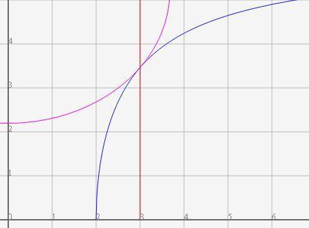

Ironically, the reviled rubber sheet analogy gives the correct answer here. Initially stationary objects would accelerate straight towards the centre (converging).
Imagine a perfectly spherical non rotating steel ball the size of the Earth. If we rotate this steel ball so that it has the same angular velocity as the Earth, we will find that clocks at the equator will be running slower relative to clocks at the poles. If we now add enough water to the surface, the liquid surface will naturally form an oblate spheroid. Clocks at sea level on this liquid surface will now all run at the same rate. This suggests that the time dilation factor is related to the gravitational potential. Stationary objects tend to be accelerated from regions where clocks run fast to where clocks run slower. Assuming some validity to this observation, a plot of the time dilation factor has some relation to the plot of the gravitational potential. This diagram shows a plot of ##d\tau/dt## on the vertical axis versus radius r on the horizontal axis, for the interior and exterior Schwarzschild metrics with ##dr=d\Omega=0##.
The magenta curve is the interior metric which represents the potential inside the gravitational object and the blue curve is the exterior metric which represents the region outside the gravitational body. The vertical red line represents the surface of the gravitational body. If the curves are rotated around the r=0 axis, an embedding diagram is generated which has similarities to a conventional gravitational well diagram (and to the rubber sheet analogy). I should mention that one limitation of the graph I have plotted is that interior Schwarzschild metric assumes constant density which is not realistic for a real gravitational body.
Like all analogies, the rubber sheet model has its limitations and it is not supposed to be demonstration of what causes gravity. It is merely a easily visualised and simple demonstration for school children of Wheeler's idea that "'Matter tells space how to curve. Space tells matter how to move" and it does not do a bad job of demonstrating that. Any objects placed on the sheet deform the sheet. Any deformations of the sheet alter how objects move along it. Any objects moving across this landscape respond to the geometry of the landscape and dynamically alter the landscape.
Another limitation is that the effective potential is dependent on the motion of the test bodies, so no single embedding diagram can represent the potential 'landscape' around a given massive body for test objects with different velocities.
(Having said all that, the diagrams and animations by A.T. are more informative and accurate representations of the effects of time and space on the motion of bodies in GR.)
