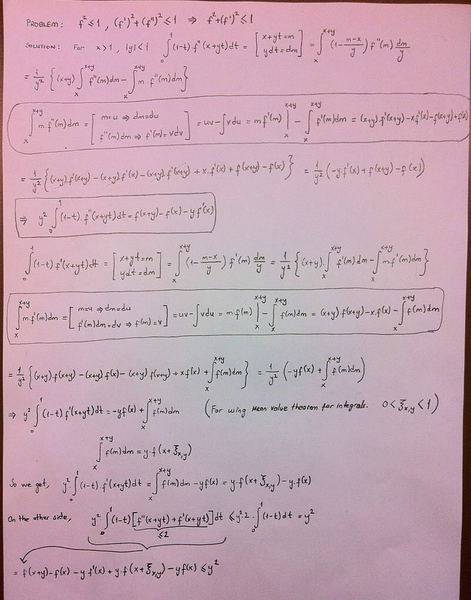

A problem about differentiability

as you know i have been asked a question which no no way i couldn't tackle it. and its is about differentiabilty. at long last i found a solution. i want to share with you. could you check out please. thanks for now.this is the question.

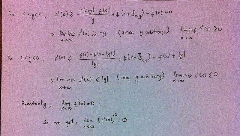

and this is my solution.(i assume that when x goes infinity, the limit value of functions equals zero.)
part1
part2
I cannot decode the first picture. However, there are functions which locally violate the assertion. So the problem comes down to: If ##f(x_0)^2 \leq 1## and ##f'(x_0)^2 +f''(x_0)\leq 1 ## and ##f(x_0)^2 +f'(x_0)^2> 1##, then there is no twice differentiable continuation of ##f## on ##\mathbb{R}##. This means on the other hand, that the continuity of ##f''(x)## is crucial for the proof!
