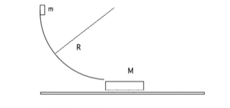

1. Homework Statement
A small mass m slides without friction on a surface making a quarter-‐circle with radius R, as shown. Then it lands on the top surface of a cart, mass M, that slides without friction on a horizontal surface. (In practice, this cart could be a slider on an air-‐track.) Between the top of the cart and the mass m, the coefficient of kinetic friction is µk. The mass m slides a distance d along the top of the cart, but doesn't fall off. (i) When there is no longer any relative motion between m and M, how fast is the cart.Show all working and assumptions and state carefully and explicitly any relevant laws or principles. (Hint: you will find it helpful to break the problem up into separate stages and to draw diagram for each.
(ii) Determine how far the mass m slides along the surface of the cart before stopping on it. State explicitly any relevant laws or principles and any relevant approximations.
