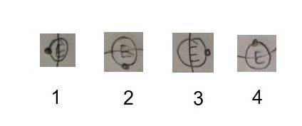

Earth rotates west to east at its axis and if we observe from sun's and Earth's North Pole the Earth would appear to revolve in a counterclockwise direction about the Sun

I think he has fixed a point on Earth like you mentioned about London...
If an observer on the sun can look down on London, would an observer in London be able to look up at the sun?
Does that lead you toward an answer to the question?
Edit: Ignoring cloud cover -- which, for London, is a pretty big thing to ignore.

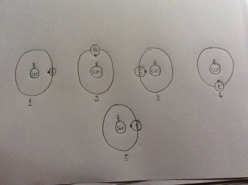

Well if Earth isn't rotating i think this is what will happen so it seems as if there is no rotation...I don't know am I right?
In your drawing, how does the observer judge the direction that the spot on the Earth is facing in his frame of reference? Does he think an observer on that spot would only ever see the same patch of sky?
A truly non-rotating Earth would not change direction with respect to distant background stars.
Just think of the Moon. You always see the same face from the Earth. So it does not rotate with respect to the Earth, but does it rotate with respect to the far away stars?
Do an experiment. You are the Moon, and you orbit around the chandelier, so as you turn toward it during your whole route. Do you rotate with respect to the room? If you see the window opposite to you initially, do you see it when you are halfway around the chandelier?
Take an arbitrary spot
In your drawing the Earth _is_ rotating about it's own axis...
Try making another one with no rotation.
