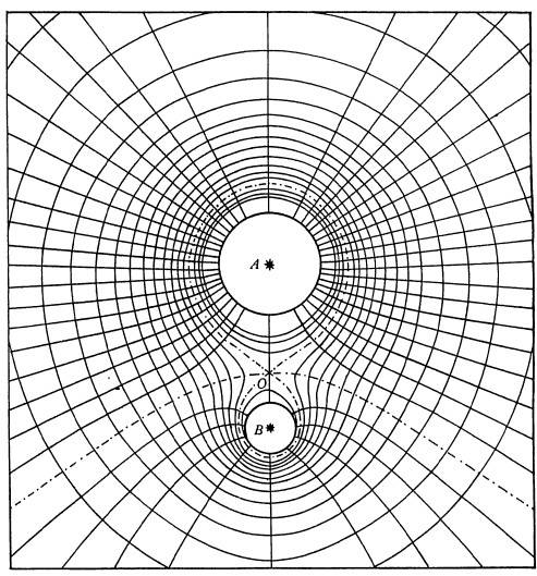

I wish to get something similar to this graph after solving
$$\frac{dy}{dx}=\frac{ \frac{kq\left(x-a\right)}{\left[\left(x-a\right)^2+y^2\right]^{3/2}}\pm \frac{kq\left(x+a\right)}{\left[\left(x+a\right)^2+y^2\right]^{3/2}}}{\frac{kqy}{\left[\left(x-a\right)^2+y^2\right]^{3/2}}\pm\frac{kqy}{\left[\left(x+a\right)^2+y^2\right]^{3/2}}}$$
this is the equation before the transformation
$$u=\frac{x+a}{y}, v=\frac{x-a}{y}.$$

Yes I tried that, but it doesn't look like the graph shown above! Also, I am trying to figure some way to graph an implicit family of curves using MATLAB or Python.

It seems to me you are not solving for the electric field, you are trying to plot the field lines and lines of equal potential. Is that correct?

I still don't see where you got this formula ##\frac{dy}{dx}= \frac{E_y}{E_x}## and what it represents. You already know the electric field everywhere so aren't you merely trying to plot the field knowing the strength at each point? It seems to me there are an infinite number of lines you could plot so how are you going to select which ones?

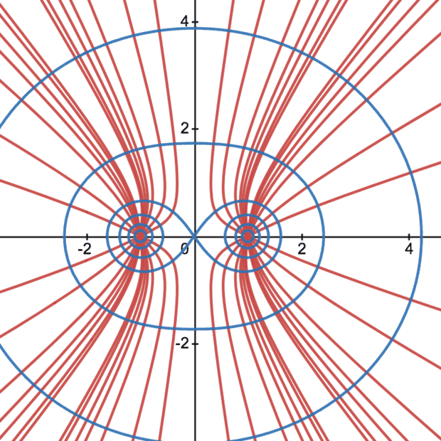

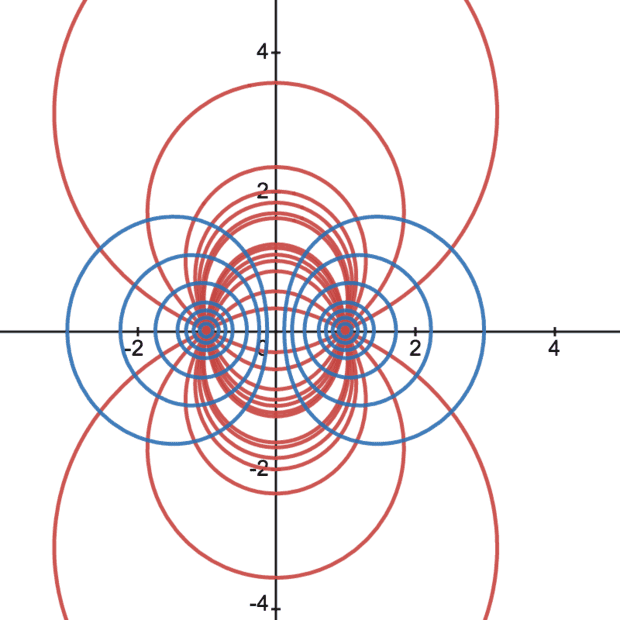

I think one can plot families of curves for like and unlike charges by assuming values for ##\frac{dy}{dx}##.
Likes PhDeezNutz
