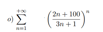

Show that the following sequence is convergent
Racine test
Good day
I have a question about the convergence of the following serie
I understand that the racine test shows that it an goes to 2/3 which makes it convergent
but I also know that for a sequence to be convergent the term an should goes to 0 but the lim(n---->inf) ((2n+100)/(3n+1))^n)=lim exp(n*log(2n+100)/(3n+1))=+infinity
I'm really confused
thank you!
What do you get if you cancel the quotient by ##n## instead of taking the logarithm?
You should rethink this part. Try plugging in a large value of ##n## and see if it's what you expect.

The denominator, 3n+1, is also inside the log.
thank you very much I just spotted the mistake!
thank you it's clear now
