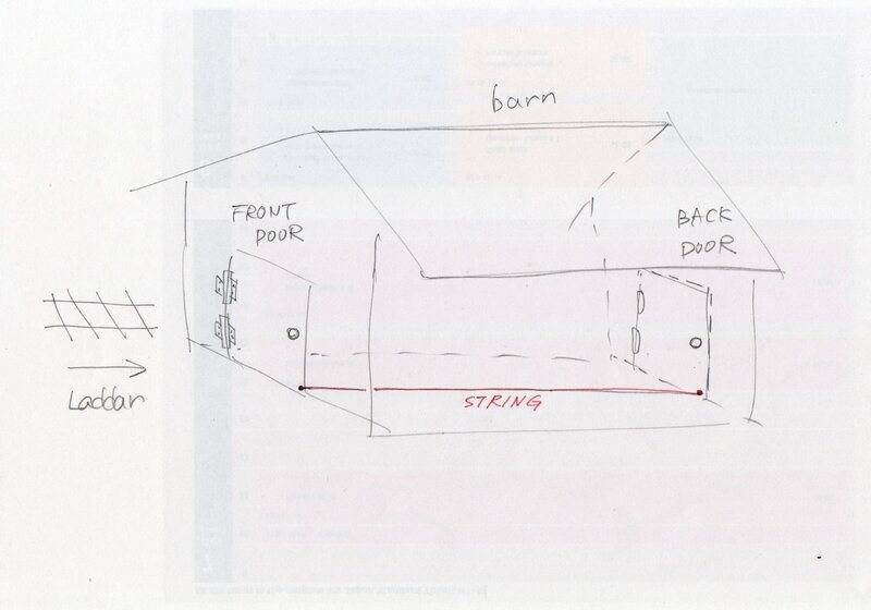

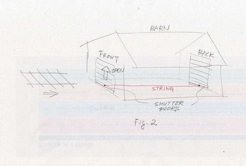

May I interpret you as one of the sketches attached ?
The string will not be broken when the doors move in a synchronized way, i.e. the two door operators do the same procedure watching their clocks one at the front wall and the other on the back wall of the barn. Of course the two clocks should be well synchronized on the ground the detail of which Einstein described in his first SR paper. We can substitute that string constraint to the above operation by watching the clocks as above said.

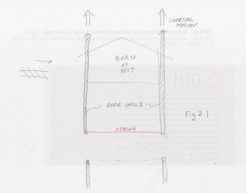

mitochan said:
May I interpret you as the sketch attached ?
Clearly not since he specifically said the doors open vertically and you've drawn doors that open horizontally. Read the thread over again. Other posts clearly recognize what he said.
One more as attached.
