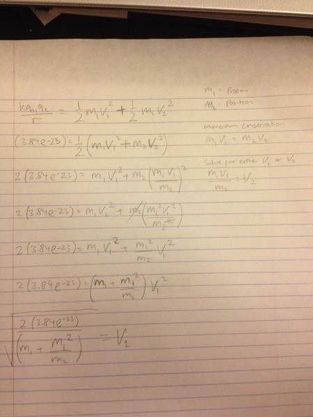

electric potential = kqq/r
energy conservation equations =
KEi+PEi=KEf+PEf
((1/2)mvi^2)+(kqq/r-initial)=((1/2)mvf^2)+(kqq/r-final)
momentum conservation
M1V1=m2v2
proton: mass (1.67E-27kg) positron: mass (9.11E-31kg)
for part a)
((9E9)(1.67E-27)(1.67E-27))/(6E-6) = 3.84E-23
i have problem on part b where i have to find the speed of positron and proton, also the percentage of KE of proton and positron have after being released and both moving away from each other
i set up the equations using energy conservation method to solve the velocity first because i thought if i can find the velocity then i know the KE ratio of proton and positron have
the formula to find the velocity is in the picture.
that is how i set it up but after i find the velocity and use it to find another velocity i got it wrong. can someone help me with this? i really appreciate it if you can show me the right way to solve for each velocity of proton and positron.
thank you so much
Do you really need the velocity? You have already found that $$ v_2 = -{m_1 \over m_2} v_1 $$ so $$ v_2^2 = {m_1^2 \over m_2^2} v_1^2 $$ and then $$ K_2 = {m_2 v_2^2 \over 2} = ? $$
In energy conservation equation. The initial potential energy later will be distributed to the final kinetic energy.
The initial potential energy is already found. While the kinetic energy is the speed of both proton and positron moving away from each other. and the momentum between proton and positron is conserved as well. Thats why i set uo my equation like that.
So, after i find out the velocity, i use it find the other velocity. By energy conservation law, there will be no energy loss in te process. Thats mean the kinetic energy (.5*m*v^2) of both proton and positron add up will be equal to the amount of potential energy the system have in the beginning. But my value is way more.
I just wondering if i set up the equation wrong of there is other way to solve it?
You might find it easier to work with momentum initially and write the kinetic energy of a particle as ##K = \frac{p^2}{2m}##.
