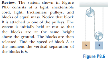

For this problem,
The solution is,
However, how do they know the block B will move up and block A will move down? The masses of each are not given so could be the other way round if ##m_b > m_a##?
Also how do they know that if block B moves up by 1cm, block A will move down by 2cm?
Many thanks!
The problem states that the masses are equal and the solution is based on that.
Thank you for your reply @kuruman !
Sorry I did not see that! I will try the problem again.

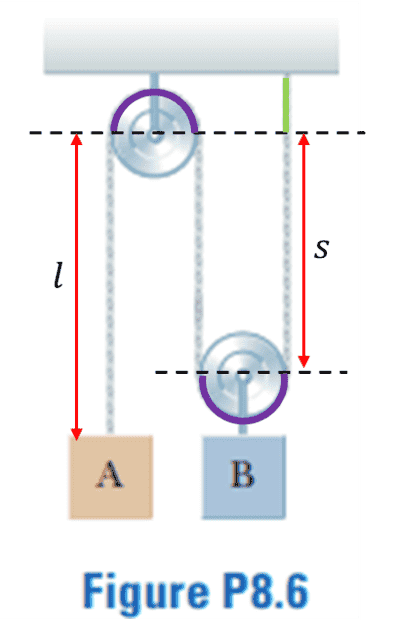

That is a matter of 'counting': in the picture you see three lengths of cord. Think of the situation that block A is all the way down: by then A has dropped by two lengths, whereas B has gone up by only one length.

I think I might see what you mean from intuition, is there way to prove this thought?

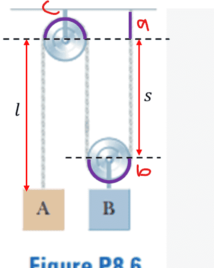

Write the total length of the inextensible rope ##L##, In terms of all the other lengths of each section. There will be a couple more steps, but that is where you start.
Likes member 731016

Thank you for your reply @erobz ! That diagram is quite helpful :)
## L = l + s + 2.5 \times purple~semicircle##

Sorry, I shouldn't have drawn that top section purple, it could be any length. I'll update the image.
1) just assign a random variable to each length that is not already labeled.
2) you are missing some length of rope in that sum.
Likes member 731016
Is the ok for the variables?
Many thanks!
From the diagram it looks like ##c = b##, but would you like me to leave it like that @erobz ?

Yeah, that will work.
##L = a + s + b + c + l##

ok, but you are still missing a length of rope there.
Sorry should be ##L = a + 2s + b + c + l## and assuming that the pulleys are the same size as the rope is taut, then ##c = b ## so simplifying gives ##L = a + 2s + 2b + l##

Great! Now identify the only variables that change in that equation when the blocks move.

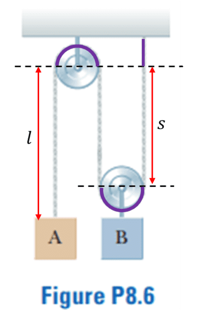

The variables that change are ##l## and ##s##

So ##l## and ##s## are the only length that can change. Apply a change to each of the variables.
For instance if a varianle was ##z## we would apply a change by adding ##\Delta z## to it. etc...
Write the new equation.

The change for each length is
##\Delta l##
##\Delta s##
Which in the original equation is
##L = a + 2\Delta s + 2b + \Delta l##Many thanks!

So what is the new equation? Rember a variable that changes goes from ##z \to z+ \Delta z##.
I this this equation,
Can also be expressed as##L_i = L_f##
## a + 2s_i + 2b + l_i = a + 2s_f + 2b + l_f##
## 2s_i + l_i =2s_f+ l_f##

Here it is @erobz ,
##L = a + 2s + \Delta 2s+ 2b + l + \Delta l##

Many thanks!
Ok, now equate the two equations through the variable ##L## and cancel the terms. What are you left with?
