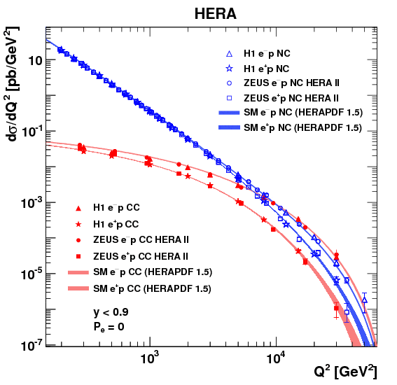

I am not sure I quite understand what is being claimed in this thread. If a collision occurs at high enough energy, there will be electroweak symmetry restoration. This is not a controversial claim, it is a measured fact. For instance, the H1 and ZEUS combined plot clearly show that the neutral and charged current cross-sections in deep inclusive electron (positron) proton scattering become equal at short distances, as predicted by the standard model :

Very interesting in deed! Could you explain a little bit more in detail what is shown in the plot?

Sure, those are cross-sections as a function of virtuality of the probe for electron (triangles and circles) and positron (stars and squares) deep inclusive scattering on protons, charged (red) and neutral (blue) currents.
For the neutral currents, the lepton remains unchanged and is detected in the final state. The probe is a superposition of photon and Z0. For charged currents, the initial lepton turns into a neutrino which escapes detection and is tagged by requiring a large missing transverse momentum. Detailed simulation had to be carried out, as reported in
Measurement of charged current deep inelastic scattering cross sections with a longitudinally polarised electron beam at HERA
The probe is a superposition of W+ and W-.

There is more than one aspect to electroweak symmetry, and certainly the scattering of high energy leptons on protons in the standard model (without neutrino mass) does not create right handed neutrinos or left handed antineutrinos. This being said, one aspect to electroweak symmetry restoration is indeed in the equality of cross-section for neutral and charged currents (in other words, it is a necessary albeit not sufficient condition), which we naturally expect to happen right above the boson masses.
