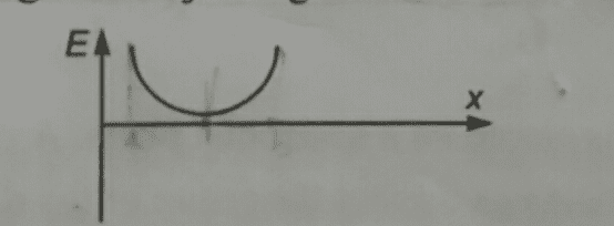

Two point charges a and b whose magnitudes are same positioned at a certain distance along the positive x-axis from each other. a is at the origin. The graph is drawn between electrical field strength and distance x from a. E is taken positive if it is along the line joining from a to b.
From the graph it can be decided that
1) a is +ve b is -ve
2) a and b are both +ve
3) a and b are both -ve
4) a is -ve and b is +ve
The attempt at a solution
As the electric field is defined with respect to a positive unit charge, a should be postive. This is because the field strength near a is tending to postive infinity, and according to the question, this is from a to b. So, this can be interpreted as repulsion.
As we move towards the middle of the graph, the strength decreases, almost to zero, so the field from point charge b must be cancelling it out. So b is also positive.
But why does the graph go towards positive infinity again? Because if b is also postive, won't it push our test postive unit charge away? This direction would be from b to a, right? Shouldn't the graph go to negative in that case?
The answer is given as a and b both being positive.

You are right, a must be positive and b too, as the electric field of the charges look to cancel at the middle of the distance.

So the graph given in the question is not possible with any combination of positive and negative charges?

The graph seems to suggest a positive and negative direction for E, that is + towards +x and - towards -x.
This means as q+ approaches charge b it is experiencing an ever increasing force towards the +x direction.
Which would suggest that b is negative as you thought.

No. Maybe, they mixed the plot with that of the potential. If it was the electric field, it should be exactly zero at the center. The potential would have a minimum there.
It depends from what direction that q+ charge approaches b. Moving from left towards b, it experiences force towards the -x direction.
Not stated where b is located though.
Should be where she drew it in pencil.

Oh, the 've' is the 've' in posti've'. I'm sorry about that! My question sheet is a photocopy, there's a statement at the end of the original (which is cut off here) that says the graph is plotted between a and b only.
Then the graph probably just indicates that the E field is increasing and do not take the direction into account.

I think they plotted the potential function instead of the electric field. E should be zero somewhere on the line ab between the charges. It is not in the plot, there is a minimum instead. The potential goes to + infinity at the positive charges, and has a minimum between them.
