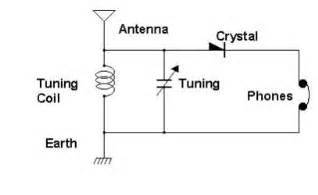

The frequency is too high for your approach to work. AM radio signals are impressed, or "modulated," onto a radio frequency (RF) carrier that ranges in frequency from 530 to 1600 kHz. For efficient reception, some sort of resonator tuned to the carrier frequency is required. This also selects the particular channel you are interested in while rejecting other channels. The selective function is often performed at an intermediate frequency (IF), such as 455 kHz, which is reached through a process called "mixing" or "down-conversion," but it is possible to perform this selectivity at RF without any down-conversion. This latter is done in a "crystal radio," for example. Finally, to lift off the information (sound) or modulation from the carrier requires a "detector" which is a non-linear electronic element. There are many devices that can perform detection; a diode followed by some sort of low-pass filtering is common. These are the minimum elements needed in addition to your antenna and headphones.
Old-fashioned crystal radios (so-called because the detector diode was formed from a piece of mineral or crystal) contain little more than these elements. You can build a modern crystal radio and use it to listen to AM radio stations. Here are two examples:
http://www.sciencebuddies.org/scien...ctricity-electronics/crystal-radio#background
http://sci-toys.com/scitoys/scitoys/radio/ten_minute_radio.html
I encourage you to do a web search and to try your hand at building a crystal radio. You will find lots of information about radio waves, modulation, and detection, as well as radio construction.

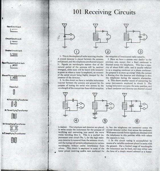

My very first radio receiver when I was about 8 years old was an unpowered crystal radio receiver with a long wire antenna outside my bedroom window (I think it was about 30 meters long running out to a tree). The only thing missing from your list is the crystal or other rectifying diode mechanism to recreate the baseband audio signal from the RF received AM signal...

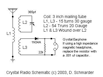

As Marcusl nearly said, you don't need to add much to your design: a diode is enough, if your radio wave is simple AM. Selectivity, as Marcusl did say, is an issue, if you want to choose which station to listen to. If you have a strong local signal (as I do), it is like listening to someone near to you with others talking in the background, but you don't have much choice. If you try to listen to someone else, loudmouth just keeps talking on top!

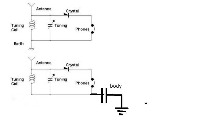

Ok. So now I've done the obvious and tried it!
First thing I noticed is, we'd all forgotten the earth. If electricity does come down the long wire, it has to go somewhere. You can also use two long wires, a counterpoise instead of earth, or attach to the centre of the long wire and call it a dipole.
I chucked 100m roll of shielded twin audio flex (just handy!) out of the bedroom window and took it 70m or so to a tree and threw the rest of the reel over a low branch. It ended up between 2m and 3m off the ground*. For the other end of the circuit I ran about 20m of similar wire down to where the water pipe enters the house and attached it to the mains earthing point (probably why I'm getting so much hum.) (* pathetic for an aerial, but I just couldn't throw it any higher.)
As expected, I can't hear much with just the wire and headphones (and earth), maybe a bit of 50Hz hum.
When the diode was added (actually the BE junction of a small Ge transistor 2G345A) I can indeed hear Radio 4 ( presumably Droitwich, 500kW about 20 miles away) audible, but hardly intelligible. I can tell it is speech, but not understand what's said. I listened to R4 on a real radio and compared the speech/silence pattern to satisfy myself that it was in fact R4. The 50 Hz is very noticeable with the speech: possibly it is modulating the speech because the diode is operating very non-linearly.
The millions of other radio sources I can't hear, but no doubt with a bit of amplification (or maybe younger ears) they would be noise in the background with maybe one or two stronger ones being identifiable as distinct sources. Even with a selective receiver one can't get away from received noise until well up in the HF band.
As has been commented on above, any old bit of wire is still a tuned circuit. With my wire so low I guess the large capacitance favours low frequency and I'm already selecting for R4 on 198kHz over the MF stations which are much more common. (But 500kW must help!)
not really

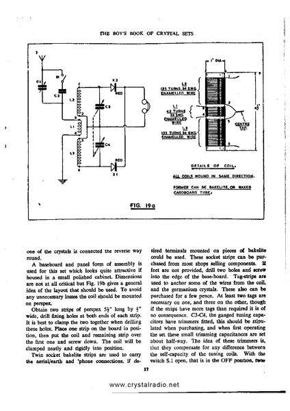

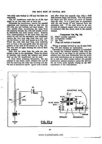

those of us that know about radio receiver ... particularly crystal sets know that an Earth helps lots
but it will work well without a physical earth
typical cct ...
will work without the earth
generally if you use 2 separate coils the primary will be connected to antenna and Earth and the secondary wont
need to have an earthed side, but it does help :smile:
there's so many variations out there!
Dave
Likes Asymptotic
I'm not sure what you're trying to say here. All your circuits show an earth?
Perhaps you mean they will work if modified by omitting the earth?
But then, as I've indicated, I think you're simply using stray capacitance, mainly through the body of the user. Not as effective as a piece of copper wire to a piece of buried metal, but something. Maybe I haven't shown enough series capacitors - chassis to body, body to radiator, pipe to ground or whatever.
If there is no Earth around, then we'd have to make do with the free space capacitance of the set and the body capacitatively coupled to it.
Whatever. But current always goes somewhere and with RF it's usually through stray capacitances if you haven't provided anything better (& often, even if you have!)
So perhaps I'm wrong to say people have forgotten the earth, maybe they just ignored it or took it for granted.
ohh dear, you really didn't read my post, huh
yes
if you had read my text ... YES ... UNLESS they are the dual coil typepays to real all the text :wink:

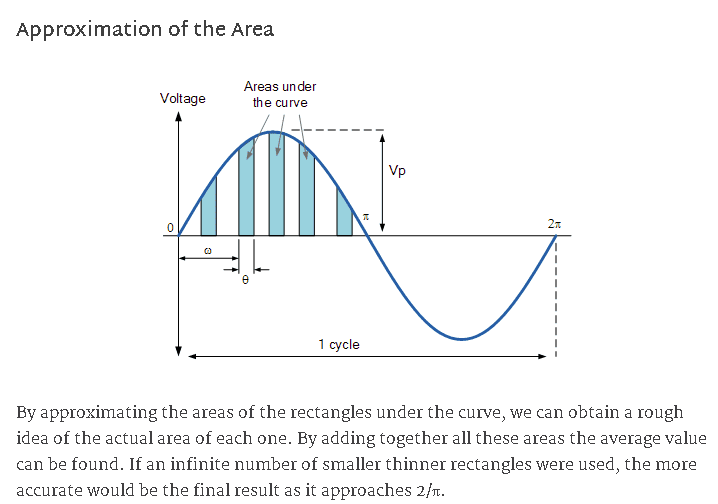

Since OP does not seem versed in "RF Detection" , here's the basic physics of it:
the average of a sinewave is zero.
The diaphragm in op's headphone can only move in audio frequency range, it's too massive to move at radio frequency. That's a Mechanical not an Electrical limitation.
So the diaphragm will mechanically average the radio frequency sinewave received on the long wire antenna.
It will move according to that average, which is zero, so no sound .
That Merlin heard power line frequency hum proves that the diaphragm can reproduce radio waves provided they fall in the audio frequency range.
Adding a rectifier, as he did , changes the picture.
The average of a rectified sinewave is NOT zero. it's some DC value, and a quick search will show pictures.
http://www.electronics-tutorials.ws/accircuits/average-voltage.html
A headphone diaphragm will displace under DC.
Rectifying the radio frequency wave allows to the diaphragm to displace according to the short term average of that rectified radio wave, averaging being done by the diaphragm's mechanical mass - spring behavior .
That's "RF Detection" at its simplest.

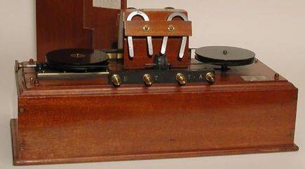

Still, the Marconi Magnetic Detector was the first really useful one . . .
https://en.wikipedia.org/wiki/Magnetic_detector

  • #32
Read the first paragraph in your link:
"It was one of the first rectifying detectors, able to receive AM (sound) transmissions. "
Perhaps I phrased it inelegantly. Giving it another go ...
Neither coherer nor Marconi's magnetic detector can demodulate audio. This milestone wasn't achieved until 1902 when Reginald Fessenden devised the electrolytic detector.
  • #34
Got it! Thanks for the clarification.
