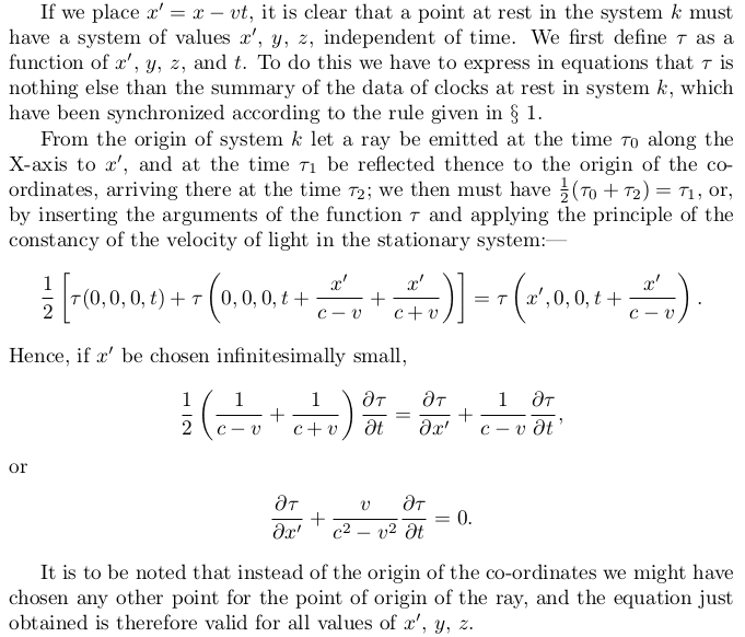

"The clocks of the moving frame of reference which are located along the line of motion are not synchronous according to the observer at rest. And LT describes how they are asynchronous.
The relativity of simultaneity test like explains why this happens, and I see discrepancy between the LT and the experiment.
I'm not saying you're wrong - I believe you're right. I just can't make these things work together."
DmitryS said:
Thanks. What about the first part of my problem?
"The clocks of the moving train frame of reference which are located along the line of motion are not synchronous according to the observer at rest on the platform.
From the 1905 paper:
... suggest that the phenomena of electrodynamics as well as of mechanics possesses no properties
corresponding to the idea of absolute rest.
Likes topsquark

Well, that's easy. In the synchronization process, when you send a ray of light from clock to clock to be reflected back, in the proper frame of reference the travel time is the same both ways. In the relatively moving frame it is ##\frac{x'} {c-v}## forth and ##\frac{x'} {c+v}## back. The sum of these gives you ##\frac{2vx'} {c^2-v^2}## and that is twice the quantity of the 'difference-of-rate' coefficient - the partial derivative of t' with respect to x - to be more exact, it is how much this coefficient is smaller than the derivative with respect to t.
