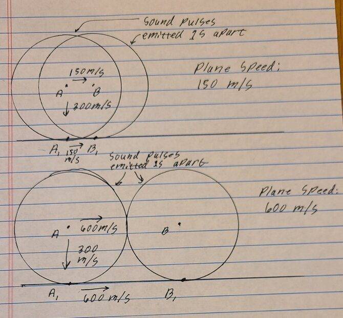

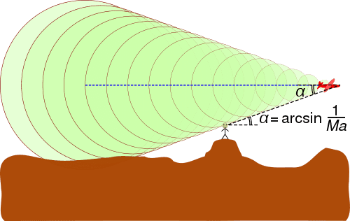

The elementary treatments I've seen show the shock wave spreading out in spheres centered on the plane and growing in radius at the speed of sound. So, clearly, the shock wave is sound, but what sound? What is it the sound of? In order for the plane to give off sound, it has to be making a sound. The only sound I know is the sound of the engines and the sound of the plane cutting through air.

The diagrams show the wave propagating from the plane in spheres. I still don't quite understand why or how the wave is created in the first place, especially if it's not sound.

I think I just didn't see your previous response. You've made it clear to me. It's the sound of air getting out of the way. The boom is a region of constructive interference. Thank you.
Those spheres are just a visual help, to indicate how the disturbance of the air pressure propagates. They are not necessarily wavefronts of some constant frequency sound that the plane produces. Moving through air at any speed procedures some noise.

Do you mean where it stops propagating faster than the speed of sound? In the image below, the strongly curved shockwave right in front of of the supersonic object is obviously also supersonic. But in the outer areas where it approaches a straight line (or cone in 3D) it also approaches the speed of sound (from above).
From: https://www.tat.physik.uni-tuebingen.de/~kley/lehre/theoast/background/fig266.html

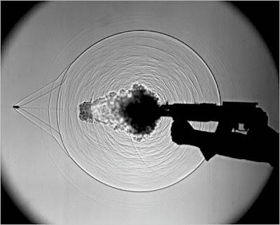

The whip crack.
Supersonic bullet. If the bullet passes you some distance away from the shooter, you might hear an initial crack (conical shock wave), before hearing the gun noise (spherical shock wave).
Likes Lnewqban and sophiecentaur

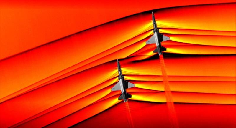

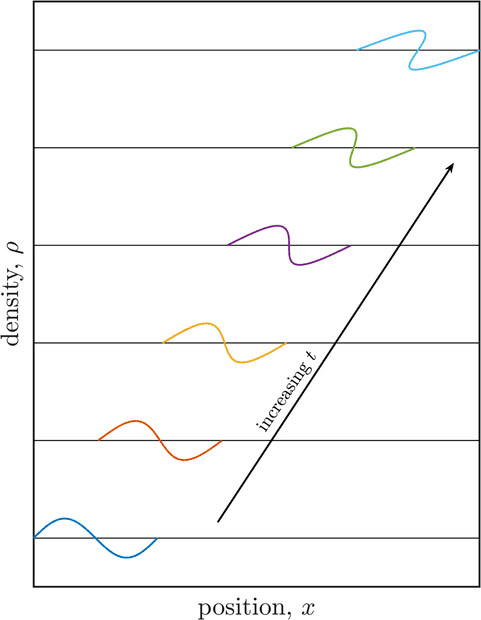

The cone shape that everyone keeps showing is not a shock wave. It's a Mach cone (conical Mach wave). The angle ##\mu = \arcsin 1/M## is the Mach angle, which is not the same as the shock angle that arises at a given Mach number and flow deflection.
In reality, the distinction between a shock wave and a sound wave is quite sharp, pun intended. Usually, sound waves are assumed to be small enough that their effect on gas properties are negligible, but what if the disturbance amplitude and its effects on gas properties are no longer infinitesimal? Any time you have a compression, the density and temperature increase and, thus, so does the speed of sound. The opposite is true of rarefaction. This means the propagation speed of a compression and rarefaction increase and decrease respectively.
If you look above, you can see the effect on a simple finite sinusoidal wave with both a compression and rarefaction component included. As it propagates, the compression portion catches up with the rest of the wave (the snapshot shown in purple). If you let this continue, you end up with a multivalued function in space (green and light blue). Mathematically, the characteristic curves of the wave equation cross. Clearly this can't happen in reality.
In the real world, as that wavefront approaches vertical (gradients approach ##\pm\infty##), the assumptions in how we approximate sound waves break down. Viscosity and heat conduction are no longer negligible at that point, each of which are dissipative and prevent the wavefront from "breaking." The nearly vertical wavefront that is sustained under those conditions is a shock, and features sharp changes in properties across it. We usually assume with no real loss of accuracy for most purposes that the phenomenon is infinitely thin and a step change, but in reality it is just a very sharp change with small but finite thickness.
When an aircraft passes through air, it compresses the air in front of it and, if that compression wave cannot find a region of the flow field where it is relieved before it breaks, a shock forms. In practice, this happens any time the flow relative to the vehicle is supersonic. The angle depends on the Mach number and the so-called "turning" angle of the flow as it moves to get around the vehicle.
I should also note that the shock wave is not just the curved portion near the front. They can propagate a fairly large distance from the source: 10s of thousands of feet. Sonic booms are absolutely the result of shock waves and not simply sound waves. If all it took was a simple sound wave, a subsonic aircraft could generate one, which does not happen.
Likes cjl, DrClaude, vanhees71 and 2 others

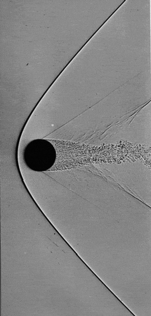

The pictures higher up are not pictures of shock waves. Shock waves absolutely do spread out in cones around the tip of of an aircraft but they are not the same as the cones referenced earlier. Those are Mach waves. See, for example, this schlieren visualization of shock waves around supersonic T-38 Talon jets.
These shocks will propagate a considerable distance, easily several miles, before they weaken enough to no longer be shocks. In fact, a supersonic aircraft flying at 30,000 ft can create a boom carpet 30 miles in width due to its shock waves (source).

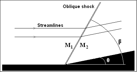

Shock waves travel faster than the speed of sound normal to their length. That's about as fundamental to shocks as it gets. If the Mach number based on the velocity component of the flow approaching normal to the wave is not greater than unity, you cannot have a shock. It follows, then, that the Mach number of the flow approaching any oblique shock (such as those emanating from an aircraft) must also be supersonic (triangle inequality). Thus, any shock wave propagates faster than the speed of sound relative to the gas approaching it (or, alternatively, relative to the gas into which it is propagating).
The cone you shared above in #13 is not a shock wave. It is, in fact, a Mach cone illustrating the concept of Mach waves and the Mach angle. It is essentially an illustration/extension of the Doppler effect when the sound source is moving at a supersonic speed.
The wave shown in #9 is a shock wave. Near the leading edge, it is what we call a bow shock (or detached oblique shock). That curved region eventually transitions into a more standard oblique shock. Those shocks will propagate a considerable distance from their point of origin.
The Mach angle is defined very simply and is based on the speed of sound waves propagating relative to a supersonic source. It is
[tex]\mu = \arcsin\frac{1}{M_1}[/tex]
where ##M## is the inflow Mach number. In contrast, the shock angle is defined very differently. For a simple 2D wedge, it is common to use the ##\theta##-##\beta##-##M## equation, which is quadratic in ##M_1^2## and depends on ##\theta## (the flow turning angle or wedge angle) and ##\beta## (the shock angle).
[tex]\tan\theta = 2\cot\beta\frac{M_1^2\sin^2\beta - 1}{M_1^2\left( \gamma + \cos 2\beta \right) + 2}.[/tex]
Clearly, ##\beta\neq\mu##. Additionally, ##\beta > \mu## and ##\mu + \theta > \beta##. Finally,
[tex]\lim_{\theta\to 0}\beta = \mu.[/tex]
The schematic below from Wikimedia commons (and the oblique shock Wikipedia page) lays out the variables. Note that ##\gamma = c_p/c_v## is the ratio of specific heats of the gas.
I will note that the ##\theta##-##\beta##-##M## does not work for conical flows, so you have to use the more complicated Taylor-Maccoll equations to solve for ##\beta## in that case, though the answers are similar to those for a wedge.
A typical supersonic aircraft might be simplified just to the nose cone. For simplicity, let's just assume it's a blunted right circular cone. A bow shock will form at the tip which will transition to a conical shock wave with angle ##\beta## according to the Taylor-Maccoll equations. This shock will propagate for a great distance (for as long as there needs to be a corresponding change in the direction of the flow) and will travel with the speed of the aircraft since it is attached to and continuously generated by it.
Likes tmbouman, russ_watters and jack action

I read that the sonic boom is sound caused by constructive interference. That makes sense as the plane acts like a distributed and not a point source but what mechanism would cause the resultant disturbance to travel faster than sound. If the reason is obvious then why doesn't someone say so? (Words of one syllable or less could help.)
There is no point in anyone describing the local effect of a fast plane moving through the air. There have been plenty of references about that and they are a very reasonable and I have taken it on board.
I read that the shock wave from a nuclear explosion will travel six or seven km. Thereafter, the disturbance becomes sonic. Interesting and the distance must scale down for an aircraft quite significantly. Bearing in mind the relative volumes of gas and the energy involved, an aircraft shock wave wouldn't seem likely to reach the ground from normal altitudes.
The obvious reason is that the plane is traveling faster than the speed of sound, so the cone that surrounds it and moves with it moves faster than the speed of sound. It has to.
It's probably also useful to look at the water droplets analogy again. The individual waves propagate from the source at the speed of "sound". The lines connecting them move parallel to the source at the speed of the source. I guess maybe the simple answer is geometry? Or maybe that the cone is in a way virtual (like the intersection point between scissors?)?
  • #32
The sound from a passing sub sonic aircraft also follows a cone which also 'travels' with the aircraft. The wave that hits you is traveling at the speed of sound and not the speed of the aircraft so your argument is hardly conclusive. What the 'virtual cone' does is not relevant to the propagation speed of the wave as it goes past you; its apparent source (for a sub sonic aircraft) will be more or less where the plane was at a previous time d/c before. You can identify a direction if the DF of your hearing is up to it. For a supersonic craft the time for the sound of the shock wave will be different. My basic question is how different? The early part of the propagation will / may take less time.

  • #34
A.T. said:
Is ##\theta## decreasing with increasing distance from the supersonic object? If yes, at what distance does it roughly become negligible, so ##\beta \approx \mu##?
That depends on the shape of the object. If the object is, say, a cone, then ##\theta## won't change unless and until the flow comes under the influence of something else (e.g. another wave or solid object).
