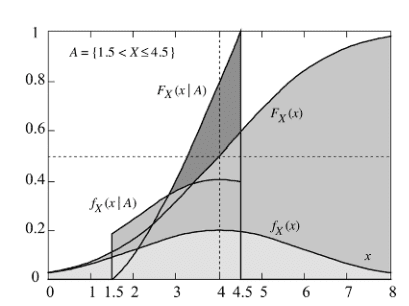

When we use terms such as 'conditional probability pdf and cdf', by that we mean:
where A is some event, a subset of a sample space. This event A must also be the domain of our functions defined above. It's a 'new universe', so to speak, for conditional probability cdfs and pdfs, and they only make sense if we look at them over this event A. For example, if we look at the random variable X with Gaussian distribution, and we denote event A as A={1.5<X<4.5}, then the corresponding conditional probability functions (pdf & cdf) look like
As you can see, they're defined only over interval [tex]{1.5<x<4.5}[/tex], otherwise they wouldn't make sense.

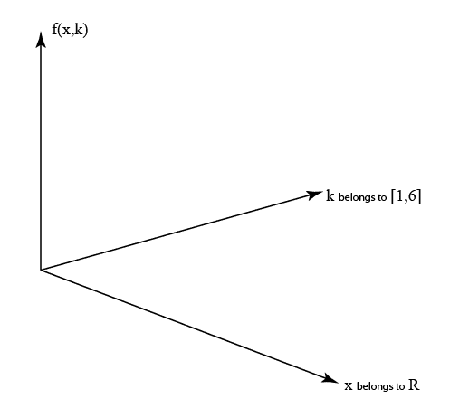

Hey Stephen, thanks for your answer! I really like this example [itex] f(x,k) = (1/6) f_1(x) + (5/6)f_2(x) [/itex]. But does that mean that we could visualise f(x,k) as
Am I right? Or is this wrong too?
Because I think you're trying to tell me that I'm wasting my time trying to present everything in terms of probability and sample spaces. For example, how would I present [itex]f_1(x)[/itex] here, as a section of [itex]f(x,k)[/itex] and a plane [itex]k=1[/itex]?

It is correct to visualize f(x,k) in the coordinate system you illustrated.
how would I present f1(x) here, as a section of f(x,k) and a plane k=1?
Yes, with the understanting that f1 means the density on the condition that k = 1.
