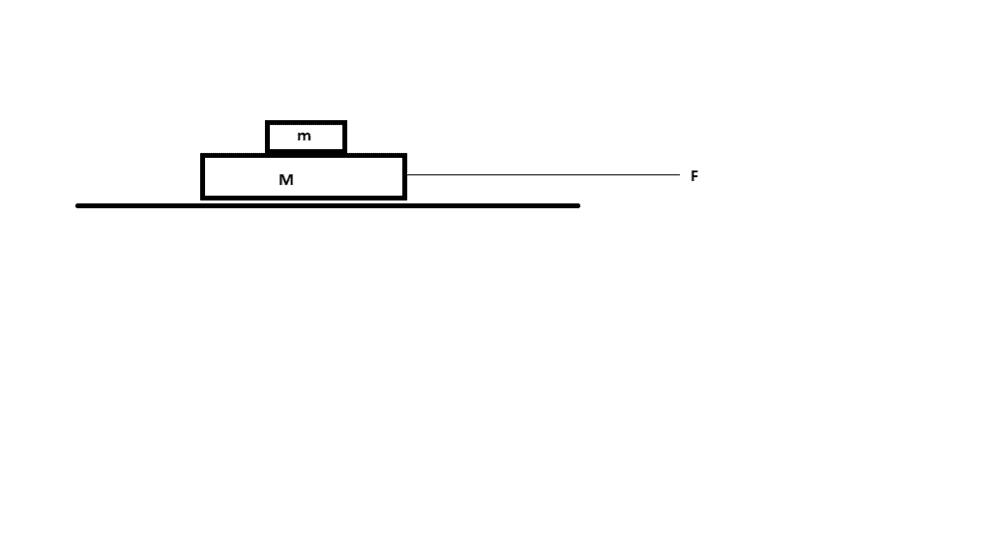

A ship is traveling at constant speed, i.e. the engine exerts a force equal to the drag force acting on the ship (right?). A cargo box is standing on the deck of the ship and is secured with a rope to the mast (see pic). When the ship kills the engine, the drag will create a sudden change in velocity, which (given that the ship's initial velocity is high enough) causes the box to continue moving relative to the ship and there will be a tug on the rope. How do I calculate the force acting on the rope? I figure that I can't use the same calculation as with a collision, since the deceleration is created by the ship's drag, which means that the deceleration won't be uniform. I already know the drag of the ship, it's speed and the mass of the box.

Very well. That particular problem in various guises is a staple of first year physics courses.
We have two blocks sitting atop one another on a frictionless table. The upper block has mass m. The lower block has mass M. A massless rope is tied to the lower block and pulls rightward with force F.
Assume that the force of static friction is great enough that the two blocks move as one.
a. What is the acceleration of the lower block?
b. What is the acceleration of the upper block?
c. What is the magnitude of the horizontal force of the lower block on the upper block? Does it act rightward or leftward?

a. a = F/(M+m)?
b. a = F/(M+m)?
c. m * a? Rightward?
Is this correct?

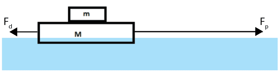

Let's modify this example to get closer to my initial question:
Instead of a sitting on frictionless table, the blocks are now floating (as in, being buoyant) in a fluid. Instead of a massless rope, the blocks are now being propelled by an engine through force Fp. The drag of the fluid is creating a force, Fd, resisting the rightward motion of the blocks. Assume that the blocks are moving with a greater than 0 velocity (v) that is constant, which means that Fp and Fd are equal.
Now, Fp becomes 0 (loss of propulsion), leading to a deceleration of the blocks caused by the drag force, Fd.
a. What is the deceleration of the lower block?
b. What is the deceleration of the upper block?

Now if we have the ship (##M+m##) going left, drag (##F_d##) pulling right and we turn off the engines, the answers are still as above.
I am not sure what the cargo box of mass m is doing to make the problem more understandable.

This seems eminently reasonable since ##\frac{d}{dx} \frac{1}{x} = -\frac{1}{x^2}##
The referenced article does not make it clear that after the transition from quadratic to linear drag one is going from ##\frac{dv}{dt}=-k_qv^2## to ##\frac{dv}{dt}=-k_lv## where ##k_q## is the constant associated with the quadratic drag regime and ##k_l## is the constant associated with the linear drag regime.
The truth is that drag is never truly proportional to the square of velocity. Nor is it ever truly directly proportional to velocity. Rather, it is (well approximated as) a sum of the two. i.e. drag = ##k_qv^2 + k_lv##. For high speeds, the quadratic term dominates. For low speeds, the ##v^2## term gets smaller faster than the ##v## term and the linear term dominates. To make for a differential equation that can be solved analytically, it is convenient to ignore the non-dominant term. Note that I am spit-balling here outside my area of expertise. I am not a fluid dynamics guy.
In the quadratic drag regime the distance traveled is nominally infinite. But the time taken gets exorbitant and the velocities get very low. Clearly one slows down and transitions to the linear regime before going exceptionally far.
In the linear drag regime the new differential equation results in exponential decay and a finite distance traveled even over infinite elapsed time.
Yes, I am familiar with derivatives, integrals and diff equations.
Then you should be able to write the differential equation: ##\frac{dv}{dt} = -kv^2## for some positive constant k derived from the coefficient of drag, the cross-sectional area of the ship and the mass of the ship.
This reminded me, when my buddy was teaching me how to handle small boats, his advice was "never approach a dock faster than you're willing to hit it." :smile:
Likes jbriggs444
I am starting to think that taking the rate of deceleration into account and all that, is complicating things unnecessarily and that the F=ma approach might be valid and a close enough approximation for my application.
The fact that I am only interested in Fmax, which occurs at V0, which in turn is the only instance at which I know the acceleration, makes F=ma applicable I guess.
Would I have needed to know the force acting on the cargo over time, I would have had to dive into jbriggs444's equation and plot the force(s) resulting from this. @jbriggs444 now that you have dived into the world of quadratic vs linear drag and all that - do you agree that the F=ma approach is sufficient for me to calculate the force within an error margin of, say, a half order of magnitude?
Thanks for all the help guys!
