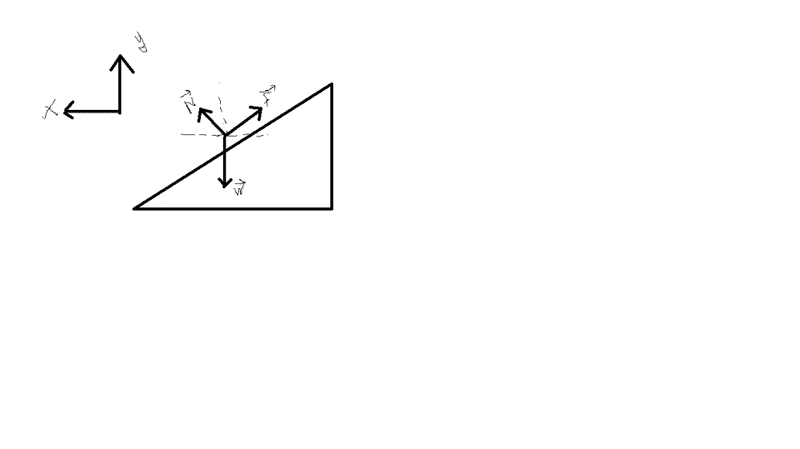

Here F is The force that cannonball applies, I showed my referance frame, m is mass of object, a is the acceleration of object inside the cannonball.
In this referance frame I can write the components of force.But is it a better then my pre-referance frame...
Components are ;
w=mg (-y)
N=Ncos37 (x) + Nsin37(y)
F=Fcos53 (-x) + Fsin53(y)
so Ftotal=ma cos53 (-x) + ma sin53 (y)
so ;
-ma cos53=Ncos37-Fcos53
and
ma sin53 =-mg+Nsin37+Fsin53
Deal with the trajectory first. Find the KE with which he must emerge from the barrel.
I can use only Newtons's Law.
And I just don't want to solve the question and leave there.I want to know where am I doing wrong.
Thanks
Thanks
You will have to deal with the trajectory at some point, and that also uses Newton's laws.
But if you wish to start with the cannon, ok.

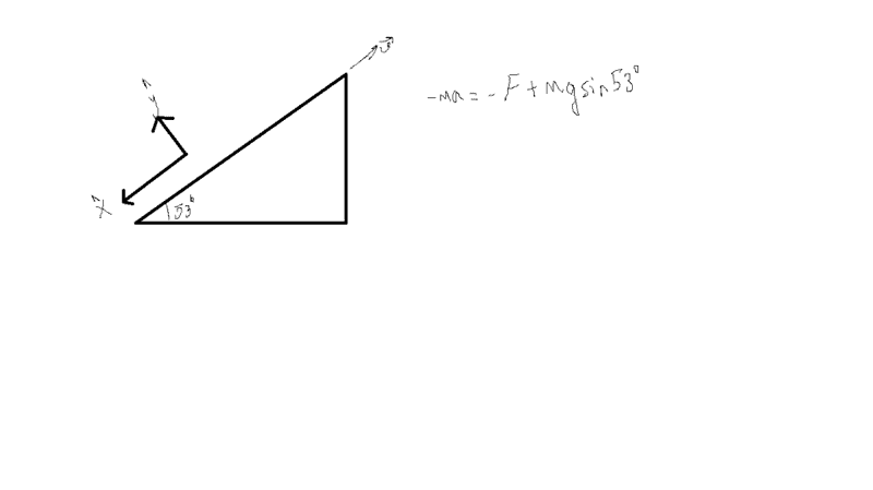

It will be much easier if you use a coordinate parallel to the ramp. Try writing the F=ma equation for that.
You won't need to work with a second coordinate.
I didnt want to use energy cause the book hasnt arrived there yet.So this question has a solution without using any energy transformation.(If that was your point)
So there's two equations.(Theres a pic in my #3 post A simple question about Force )
##-ma = - F + mgsin(53^0) ## (Eq-1)
##F:\text{The force that we wanted to know}##
##a:\text{acceleration of object}##
##N=mgcos(53^0)## (Eq-2)
Ok, that relates F to a. Next, you need to relate a to the launch speed. What equations do you know that would do that?
##v^2-(v_0)^2=2a(x-x_0)## So here ##v_0=0## and ##x_0=0##
so If we use this equation to in our referance frame we willl get
##v^2-0=2(-a)((-x)-0)## which equals to;
## v^2=2ax##
Ok I solved the problem.Just I made a simple false assumption.And then I couldn't solve cause of that.Now I solved thanks again
