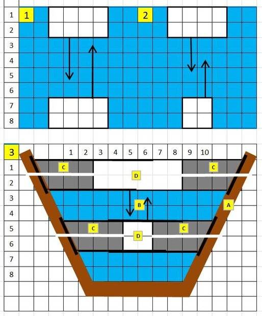

Attached 'Waterbubble.jpg' - comparing energy input required to push a volume to the bottom of a liquid with the resulting P.E. at the bottom position - includes 3 scenario's;
1. A rigid volume of air where we need to excert a vertical downwards energy to push the object to the bottom where it will have gained an equal amount of P.E. 2. The same object but now with sides which can be compressed. As a result less vertical downward energy will be required to push the object to the bottom (as a result the air volume will be compressed by increasing waterpressure) and less upward P.E. will haven been gained than in example 1 (if we ignore the P.E. of the compressed air volume) 3. Would be similar to scenario 2 (same amount of energy input required to arrive at an identical P.E.?) except for the fact that in this case the volume of air is not changed by waterpressure?

  • #38
You trying to build a "PPM/over-unity device?" Es ist verboten. See "Forum Rules." There was a "bubble power tower" discussion somewhere on the forum ...been long enough in the past that search fails/ed....

In post 24 I provided an example on how the object could move up or down only because I was challenged to think about this as a result of the questions in the earlier posts (for example 4 and 21)
Not sure how this related to 'waterbubbles' (or a 'bubble power tower') which was initially brought up by A.T. as an example whereby an increase in airvolume of a submerged object does not neccesarily result in an increase of the P.E. of the watervolume?

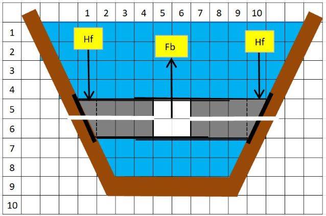

A.T. said:
Yes, but you could add up all the other forces, to find the slanted area forces needed to hold the object in place. That will tell which way the object will move, if you would actually be able to build that sliding sealed contact with negligible friction.
I do not intend to build anything. Solving Fb for the total volume of the object (note that in this case calculating Fb as the difference between the top and bottom area does not work); Fb = V * p * g = 18 cm3 * 1 kg/m3 * 9.81 m/s2 = 0.1766 N. For the downwards hydrostatic force on top of the slanted area's; Hf = p* g * h * A = 1 kg/m3 * 9.81 m/s2* 4 cm * 2 cm2 = 0.0785 N. The resulting Fb(res) = Fb - Hf = 0.0981 N. W = m * g = 0.014 kg* 9.81 m/s2 = 0.1373 N. The object will therefore move in a downwards direction. Unless there are any further questions this topic can therefore be closed. I would like to thank the advisors on this forum (especially A.T.) for their patience and guidance resulting in a learning curve on my part.
