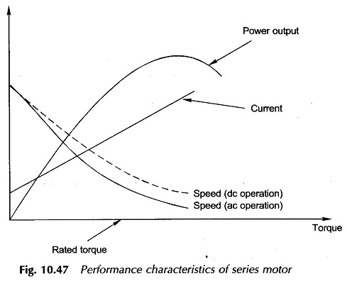

The problem you have is that these are series motors, they behave distinctly differently to a permanent magnet DC motor.
For a permanent magnet DC motor voltage basically determines the speed, almost independent of load torque (assuming you can supply the current). This is because the magnetic field strength is fixed by the permanent magnets, therefore you get a constant X rpm/volt. Then as you increase load torque, the current increases, and the speed drops a little due to winding resistance introducing an internal voltage drop.
A universal motor does not have a constant field strength, the field strength is dependent on the load torque, this is because the field current and rotor current are the same since the windings are in series.
So at the two extreme ends of speed here is what happens (assume fixed voltage applied).
0rpm: Rotor generated back emf is zero volts (not moving), so now maximum current flows through the stator and field winding creating the largest available torque for the machine.
Maximum speed: Current is low which means field current is low, this reduces generated BEMF as speed is increasing resulting in very high no load speeds.
So as speed increases, the field current, and thereby field strength, is going down, this reduces back emf generated per speed, resulting in a non linear response to load torque and allows almost exponentially more machine speed before you run out of voltage.
Basically universal motors are self field weakening as their speed increases, which allows them to have enormous no load speeds, easily >20krpm.
This is what it looks like (fixed voltage):
So, unlike a regular PM DC motor, a fixed voltage (ie a PWM of fixed duty cycle) does not set speed the same way. As you've found, at a given fixed voltage if the load changes speed changes dramatically.
The only way to control it really is with some sort of speed feed back to change the applied voltage as load changes.

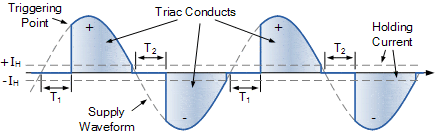

The off-the-shelf train controller I have chops the 60 cycle sine wave, like this:
https://i.stack.imgur.com/2G4gT.gif
from:
https://electronics.stackexchange.c...quest-for-explanations-of-how-things-inside-w
which, I think, is better than transformer control by itself, as is maintains that peak to provide torque. But after a thorough cleaning of the motor, track, and (most importantly, I think) soldering most of the connections between track sections with a copper jumper wire, it is running consistent enough that I really don't need a speed limiter, or other 'solution'. But I learned a lot in the process, and kind of want to do it anyway, just because. But other projects are in the wings.
Thanks.
