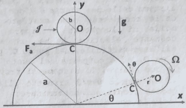

A sphere of radius ##b##, mass ##m##, moment of inertia ##I_0## sits on the top of a hemisphere of radius ##a## with friction coefficient ##\mu##. An impulse ##J## is applied horizontally to the center of the sphere.
The friction ##\vec{F}_a## is such that the sphere can roll without slipping.
The sphere moves along the hemisphere until reaching angle ##\theta_D## (known), and at that point it loses contact with the hemisphere.
Find:
a) The relationship between the angular velocity of the sphere with respect to its center of mass ##\Omega## and the angular velocity of the center of mass of the sphere with respect to the center of the hemisphere ##\dot{\theta}##;
b) The angular velocity ##\Omega## and the kinetic energy just after the impulse is applied;
c) The angular velocity of the center of mass at ##\theta_D##;
d) Magnitude of the friction force for angles ##\theta>\theta_D##
e) The horizontal component of the velocity of the point of the sphere that touches the ground, at ##y=0##.
##\vec{J}=\Delta\vec{p}##, ##v=\Omega r##, ##E=K+U##, ##\vec{\tau}=\vec{r}\times\vec{F}=I\alpha##
a) From impulse-momentum theorem I have: ##J=mv## so ##v=\frac{J}{m}## and since the ball doesn't slip ##v=\Omega b## so ##\Omega=\frac{J}{mb}## and ##\dot{\theta}=\frac{v}{a+b}=\frac{\Omega b}{a+b}##.
b) I considered the angular impulse: ##-J(a+b)=I_0 \Omega_0 \Rightarrow \Omega_0=-\frac{J}{I_0}(a+b)##.
For the energy I have: ##\fbox{E}=mg(a+b)\sin(\theta)+\frac{1}{2}mv^2+\frac{1}{2}I_0 \Omega^2## and since the sphere is rolling without slipping ##v=\Omega b## hence ##E=mg(a+b)\sin(\theta)+\frac{1}{2}m(\Omega b)^2+\frac{1}{2}I_0 \Omega^2=mg(a+b)\sin(\theta)+\frac{1}{2}(I_0+mb^2)\Omega^2##.
c) Using conservation of energy I have: ##E_i=mg(a+b)+\frac{1}{2}(I_0+mb^2)\Omega_0^2, E_f=\frac{1}{2}\Omega_D^2 (I_0+mb^2)+mg(a+b)\sin(\theta_D)## so from ##E_i=E_f## I get ## \Omega_D=\sqrt{\Omega_0^2+\frac{2mg(a+b)(1-\sin(\theta_D))}{I_0+mb^2}} ##.
d) ##-bF_a=I_0 \alpha \Rightarrow |F_a|=|-\frac{I_0}{b}\frac{d\Omega}{dt}|##, where ##\Omega=\sqrt{\Omega_0^2+\frac{2mg(a+b)(1-\sin(\theta))}{I_0+mb^2}}\overset{(b)}{=}\sqrt{(-\frac{J}{I_0}(a+b))^2+\frac{2mg(a+b)(1-\sin(\theta))}{I_0+mb^2}}##.
e) ##v_x= - b\Omega_D## (negative since the rotation is clockwise)
I am quite unsure about how I solved this problem so I would appreciate if someone would check it out and give me some feedback. Thanks.

Are you not disturbed by the different expressions for the initial value of ##\Omega## in parts (a) and (b). Which one do you think is correct and why?
You have a mixed bag of expressions for the potential energy that do not treat the position fo the CM of the sphere consistently. I recommend that, for the purpose of writing down the potential energy, you consider a point mass at distance ##(a+b)## from the center of the hemisphere.
You need to draw a free body diagram in order to relate the value of the angular speed to the critical angle ##\theta_D## when separation occurs.
These are my first impressions without having solved the problem. If you haven't solved the problem of a point mass sliding off a frictionless hemisphere, I suggest that you do that as a warm-up exercise.

The question is a bit flawed. Given a horizontal impulse of arbitrarily short duration, there is no possibility that sliding was avoided. That would take a correspondingly arbitrarily large coefficient of friction. The sphere would have lost contact immediately.
However, if we assume such a coefficient initially, there must be a horizontal frictional impulse the other way from the hemisphere to achieve rolling. Maybe the author wants you to take that into account.

But if I consider the forces in the tangential direction won't the the angular velocity appear due to the presence of its derivative in Newton's Second Law? Namely, I get: ##mg \cos(\theta)-F_a=ma \alpha## (I use ##\cos(\theta)## since the angle is measure from the horizontal)

What if you consider a sphere placed at that position and released from rest? How would you calculate the frictional force then?
##F_a =-\mu N=-\mu mg\sin(\theta)##
Yes, for (d) draw an FBD of the sphere at that angle and figure out how much static friction is needed to provide the tangential acceleration. This part is the same as asking for the static friction when a ball is rolling down an inclined plane at fixed angle ##\theta_D##.

Use the relationship between linear acceleration and angular acceleration, and the corresponding torque and force equations.

I believe that before the sphere has detached it must roll with slipping.

##mg\cos(\theta)-F_a=ma_t=mb\alpha,\ N-mg\sin(\theta)=ma_r,\ -bF_a=I_0 \alpha##; from the last equation I get ##\alpha=-\frac{bF_a}{I_0}## which, substituted into the first equation, gives ##F_a=\frac{mg\cos(\theta)}{1-\frac{mb^2}{I_0}}##.

Interesting: why is that the sphere must roll with slipping before detaching from the hemisphere?
Because as it approaches the detachment point the normal force is tending to zero, so the available frictional force is also tending to zero. Since it is accelerating ever faster, the frictional force needed to maintain rolling is increasing.
