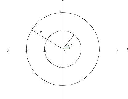

I looked around the internet and found the exact same problem, except in that case the presenter of the question was kind enough to point out that this would be easier to do in cylindrical coordinates. In any case, my guess is that I should try to calculate the volume of the hole and subtract it from the volume of the sphere which we know to be ##V_s = \frac{4}{3}\pi \rho^3##. The hole seems to consist of a cylinder, with two lobes attached at each end.
Let us place the sphere's center at the origin (note that the small r in the pictures should be ##R## considering our derivation of the volume below):

The limits on your integrals for calculating the volume of the cylinder are messed up. Perhaps just a typo, though I'm not sure where that 2R came from. And why did you set R=1 at the end when R=2 cm?
In any case, wouldn't it be more straightforward to not break it into pieces and just calculate the volume of the hole in one shot, perhaps using the method of cylinders?
Whoops. I changed my notation partway through the problem and forgot to change the original symbols to match.
