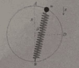

I uploaded the image of the system to have a visual example. : )
A point mass ## m ## connected to a spring is bounded to move on a circular guide with radius ## R ## without friction. The guide is fixed to a vertical plane and the other extremity of the spring is attached at point ## B ##, which is the bottom of the guide. The rest length of the spring is ## 2 R ##. Initially the mass is in the point ## A ## and at ## t = 0 ## it begins to move with a negligible velocity
1) Knowing that the mass richeas the point ## D ## with ## v=0 ##, find the spring constant ## k ##;
2) Find the acceleration ## a_D ## and the reaction ## N_D ## of the guide at point ## D ##;
3) Let ## \theta ## be the angle between the spring and the vertical. Find the angle at which the velocity is maximum.
1) I use the energy conservation. First of all I choose the zero of the potential at point ## A ## such that the initial energy is equal to zero. Then I set that equal to the energy at point ## D ##, knowing from the geometry of the system that the length of the spring in this point is ## \sqrt 2 R ##:
$$ 0 = k R^2 - m g R \quad \Longrightarrow \quad k = \dfrac { m g }{ R } $$
2) I chose the frame centered in ## B ##. Because the reaction is always perpendicular to the guide, at point ## D ## the reaction force has only a component along the ## x ## axis and then:
$$ N_D = k R = m g $$
because the mass is not moving along ## x ## in this position.
Along the positive direction of ## y ## axis there is an acceleration which is given by:
$$ m a_D - mg = kR \quad \Longrightarrow \quad a_D = 2 g $$
where i have substituted the value of ## k ##
3) Up to now, the only thing that I have in mind is that the velocity is maximum when the acceleration is equal to zero. So I tried to write down that the sum of the forces along both axes is zero but I need another condition. I thought that maybe I have also to impose the minimum potential energy but I am not so sure.
Can you please give me any hint? Also, do you think that the answers to questions 1 and 2 are correct? Thank you in advance. : )

Hello As, :welcome:
1.
Aslet said:
length of the spring in this point is ##\sqrt 2 R ##
that is correct. But the potential energy in the spring is then not equal to ##kR^2## !
2. That would mean the mass stays there ? (the vertical component would also be ##mg##, thus offsetting gravity ?)

The new answers are:
1) I choose the frame of reference centered in ## B ##. The potiential energy in ## A ## is only ## 2 m g R ## because the spring is at rest. The potential energy in D is ## m g R + \dfrac{ 1 }{ 2 } k ( \Delta R )^2 ## and ## \Delta R = 2 R - \sqrt 2 R ## is the elongation of the spring from its rest position. Then I obtain :
$$ 2 m g R = m g R + \dfrac 1 2 k R^2 ( 2 - \sqrt 2 )^2 \quad \Longrightarrow \quad k = \dfrac { m g }{ ( 3 - 2 \sqrt 2 ) R } $$
2) In point D I can assume that along the x-axis the acceleration is zero because looking at small movements from ## D ## the particle moves only along the y-axis. Thus, the elastic force along the x-axis is ## k \ \Delta R \ \sin \left( \dfrac \pi 4 \right) = k ( 2 - \sqrt 2 ) R \dfrac {\sqrt 2} {2} = k ( \sqrt 2 - 1 ) R = mg \dfrac { \sqrt 2 - 1 }{ (3 - 2 \sqrt 2) } \ > \ mg ## . The sum of the forces along x eventually gives me:
$$ N - k \ \Delta R \ \sin \left( \dfrac \pi 4 \right) = 0 \quad \Longrightarrow \quad N = mg \dfrac { \sqrt 2 - 1 }{ (3 - 2 \sqrt 2) } $$
Knowing that the y-component of the elastic force is equal to x-component, along the y-axis I find instead:
$$ m a = - m g + mg \dfrac { \sqrt 2 - 1 }{ (3 - 2 \sqrt 2) } \quad \Longrightarrow \quad a = \dfrac { 3 \sqrt 2 - 4 } { ( 3 - 2 \sqrt 2 ) } \ g \ > \ g $$
which is in accord to what I intuitively think.
Regarding the third point, I am going to do the calculation as soon as possible. Using the geometry of the system, I expressed the potential in function of ## \theta ##, now I only have to do the derivative and set the result equal to zero in order to find the angle at which the velocity is maximum. Sorry for the late but I was at University up until now. Also sorry for my english, I am not used to write in this language. : )
Do you think the reasoning is more or less correct?

1 ) ## k = ( 3 + 2 \sqrt 2 ) \dfrac { mg } { R } ##
2 ) ## N = ( 1 + \sqrt 2 ) m g \qquad a = \sqrt 2 g ##

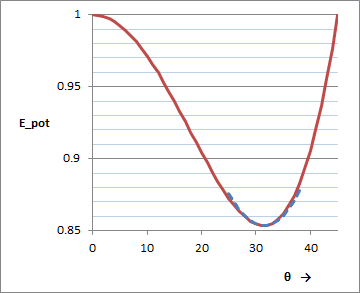

3) I call ## R_M ( \theta ) ## the position of the mass at a certain angle ## \theta ##. From the geometry of the system I find:
$$ R_M ( \theta ) = 2 R cos ( \theta ) \qquad ( R_M ( \theta ) )_y = 2R \cos ^2 ( \theta ) $$
The potential energy in function of the angle thus is:
$$ 2 m g R \cos ^2 ( \theta ) + \dfrac 1 2 k ( 2 R - 2 R \cos( \theta ) )^2 $$
Then I derive respect to ## \theta ##, put the result equal to zero and find:
$$ \cos ( \theta ) = \dfrac { ( 2 + \sqrt2 ) } { 4 } \quad \Longrightarrow \quad \theta = 31.4° $$
Actually, ##R_M## is the length of the spring, but I understand what you mean. At that point the potential energy has a minimum, so the kinetic energy is at a maximum.
Well done !
As a side note: you now have found an equilibrium position (by minimizing this potential energy). If you look at the plot of E vs ##\theta## you can understand why I sputtered when harmonic motion was brought up: E is not symmetrical around the minimum, so the restoring force is not proportional to the deviation from minimum. In physics we often look at small deviations from equilibrium and approach E for that range of deviations by a quadratic function (the dashed line) so we have almost harmonic motion for small perturbations.
Likes Aslet
