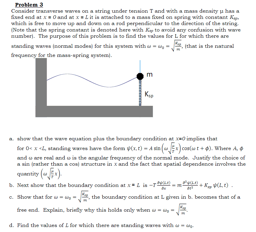

Hi all. Multiple part problem that I'm really stuck on. I'll attach a file.
At first I had attempted the whole problem with the idea that fixed wall was a fixed point, and that the mass on a spring was a "free" point. But I learned later that the mass can't be treated like a "free" point since the spring resists movement, so I'm completely at a loss on how to get started with these problems.
For part a, I tried to readjust certain variables. I knew that sqrt(u/T) is 1/v, and that w/v = k, the wave number. So I rearranged it into Asin(kx)cos(wt+phi), then readjusted cos to sin by making it sin(wt+phi+(pi/2)). I think that's still right but I'm not sure.
For part b, I know that they shared some trig functions to simplify it down some. I did that, then set k to (n+.5)/L to prove that both sides = 0 which is what I thought the boundary condition would be at x = L.
But now I know both of those are wrong, so I'm completely lost and not confident in what to do with c or d...
For part b,
Hi all. I've worked more on this and have managed to get part a, I think.
Part b I am still stuck.
I've narrowed it down to T * w * sqrt(u/T) * cos(kL) = mw^2 * sin(kL) - Ksp * sin(kL). But I'm not sure how to go forward from here. Can anyone help?
what do you think the equation they asked you prove represents does it resemble some kind of formula?

It's a second differential. I had noted that before, and I know that, in springs, F = ma + bv + kx. Here, it's just ma + kx. I also know that Fy in waves = dW/dx, which is the first differential. I could setup an equation that puts them all on the same side. Am I on the right track?
yes but just forget about f =ma +bv +kx that for now
the only thing you should use here is f=ma so the middle term represent the ma could you show that the other two terms represent force along a suitable axis

Right. Fy = T*dW/dx, which would be force along the y-axis and force = ma^2. The mass can't move horizontally, so would KspW = 0, thus not playing a factor? Since it is a standing wave, the waves aren't moving left or right, only "up or down," if that makes sense. Sorry, sometimes I am not very good with word choice.
yes this correct what do you mean by this
ma^2
in the y direction there would a component of tension but
the spring does play a factor since it is the y direction

Ah, sorry. By ma^2, I meant that force = m*d^2W/dx^2. By a I just mean the second derivative of W with respect to x.
As for the spring...I suppose then that F = m*d^2W/dx^2 - Ksp*W where I write W at L? When I had it all written down, I had simplified it down to
T*k*cos(kL) = (mw^2 - Ksp)sin(kL)
where k = w*Sqrt(u/T). Do I just need to show that T*k*cos(kL) is equal to the force to prove the boundary condition at x = L is such?

i think there is some confusion here
f = m\frac{d^2 \psi(L,t)}{dt^2}
this is f is the force on the mass
now you just need to express this f in terms of physical forces of which there are two here
the vertical component of tension and spring force if equate it with ma you get the equation in b
for part b you just have to work with ##\psi##
you don't have to concern yourself with the actual form of ##\psi##

Ok. I think I understand now. Thank you! I have figured out 3c and 3d in the meantime, so I should be good from now on.
