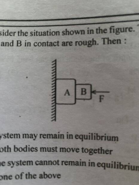

Consider the figure. The wall is smooth but the surfaces of A and B in contact are rough. Then-
1. System may remain in equilibrium
2. Both bodies must move together
3. System cannot remain in equilibrium
4. None
Newton second law.
I think there is normal force from wall and applied force will balance each other but there is no counter force against mg.Both bodies will slip and fall. I am not sure.

Did you manage to draw free body diagrams ?
[edit]
If you have to tick 1,2,3,4 (or more than one?), which is/are your best shot ?​
I have difficulties with this exercise: F is not mentioned in the text, but only appears in the picture ?​
The text uses 'remain' where you write 'be'. Also: 'must move together' and 'move together '​

Would I be correct to assume that ##\vec{F}## is, as drawn, purely horizontal?
Would I be correct to assume that gravity is present and non-zero, even though it is not drawn?
Would I be correct to assume that "equilibrium" means that the system remains at rest if it began at rest?
If so, can you go through 1), 2) and 3) and explain why each holds or does not?

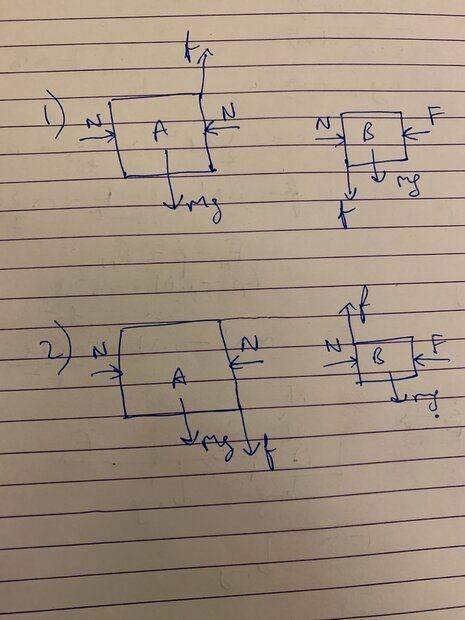

Steve4Physics said:
If A and B were both perfectly smooth (zero friction between them) what would happen and why?
Both will fall down because of imbalance of forces.
I have made the diagram and I think all are balanced in the OP. So equilibrium!
Yes, they both fall. Do they fall at the same rate?
Your diagram is wrong. And the blocks are not in equilibrium.
Part of the problem is that the OP is badly worded.
Think of holding a stone stationary (in equilibrium) in your hand. You then release the stone. What force(s) act on the stone the moment after you release it? Is the stone now in equilibrium?
Think of the OP diagram as showing two blocks the moment after they were released.

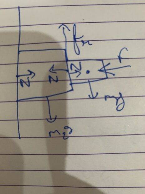

If A moves down and IF there is friction,between A and B there would be two downwards forces on B (weight and friction from A). So B would not be in equilibrium.
Due to weight of B there is upward friction on A but due to weight of A there is downward friction on B. So both will come down the moment they are released at same rate g.
I have two possibilities. Which one? 1 or 2 ?
What if we treat it as a system? I think both will come down because there is no upward forces on either of them.
Well, well. After 24 posts we now have free body diagrams. The reason I asked for them is that I would like you to discover that there are no vertical forces except the two from gravity. And they cause the two blocks to fall with exactly the same acceleration. That means there is no tendency for the blocks to move wrt each other in any direction.
You have drawn friction forces, but exactly because there are no other vertical forces, the actual friction forces are zero, which makes your 1) and 2) diagrams identical. At best you have drawn the maximum friction forces, something like ##\mu F_N##.
I think there should be no friction too because there is no upward force on any of the bodies.
But there is a downward force on both bodies. What makes upward forces special in your mind?

There have to be relative motion between A and B for the friction to occur here. Wall is smooth and no upward force on B. So both will fall at same rate due to gravity after we remove supporting forces.
As I wrote, that is for kinetuc friction. For static friction there does not need to be any actual relative motion, only that there would be relative motion if the friction were not there.

No. That's only true for kinetic friction. I will add to @haruspex's comment...
Suppose a small parachute is attached to block B. Since A and B are pressed together, there could be enough static friction to prevent them sliding relative to each other. A and B would then fall together (in the same way as if they were stuck together).
Of course If you use a sufficiently big parachute and A is very heavy, then A will fall faster than B. Sliding occurs between A and B and the friction is kinetic.

O yeah! But there is also no static friction here because of the absence of any upward force. Both will fall as one system.
