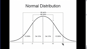

If the probability distribution of the neutrino mass that the experimental results suggest were Gaussian, it would look like:
But, in fact, the neutrino mass probability distribution implied by these experimental results has a very high peak near zero and goes steadily downward towards the right as the neutrino mass values implied by the experiment get larger.
The real probability distribution of the neutrino mass implied by this experiment looks closer to the green line in the image below, only even more steeply peaked near zero (with the red line peaking at a z= -0.65 value on the z score normalized image below):
