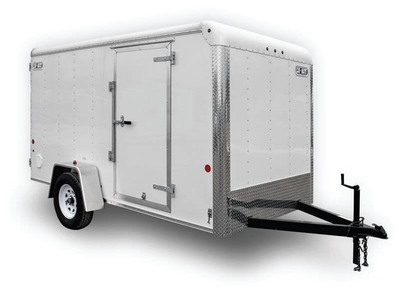

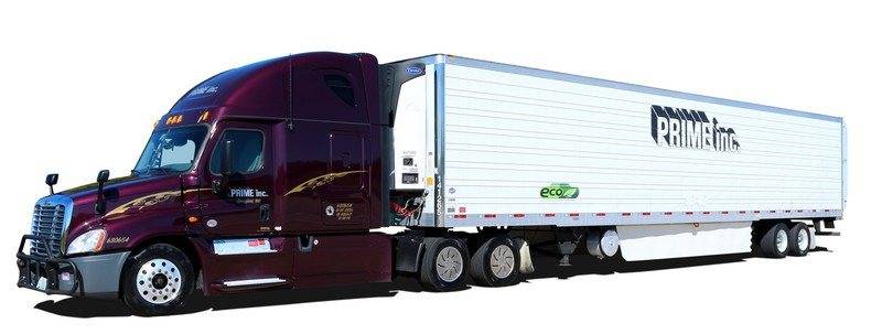

One big difference between a boat trailer (or my motorcycle trailer) and an 18-wheel trailer is that the latter has its fixed wheels at the very back, not mid-trailer. That is a reason that the back of your trailer will not react as quickly as a trailer with fixed wheels mid-way back.
http://www.ronstoyshop.com/category_images/trailer_catalog/enclosed_cargo_trailers/6_wide_trailers/trailers_car_mate_enclosed_cargo_trailer_600.jpg
http://www.utilitopics.com/wp-content/uploads/Prime-Trailer-e1422390133880.jpg
Likes anorlunda and RonL

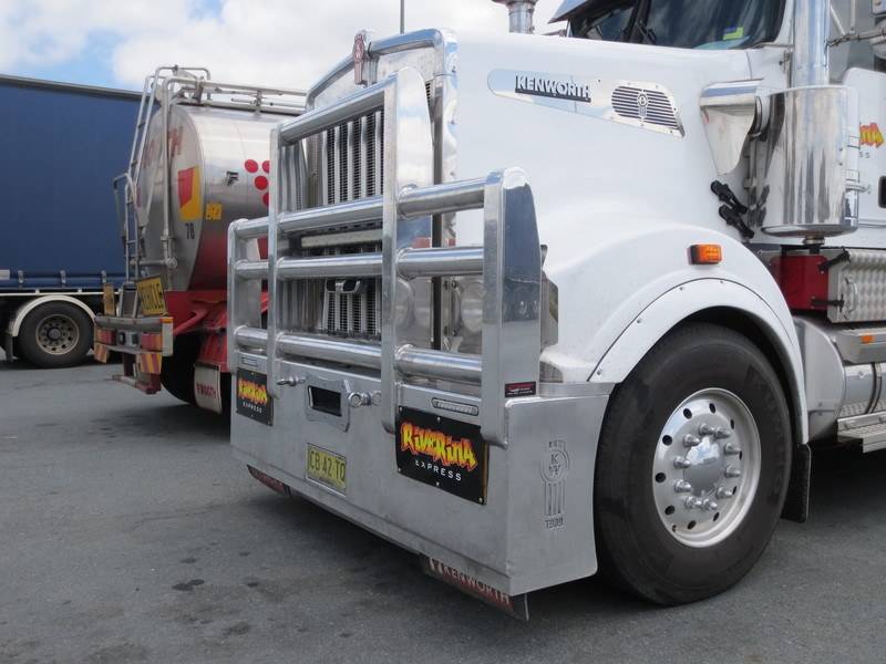

A brush guard on front of a big rig :cool: a first time view for me :smile:

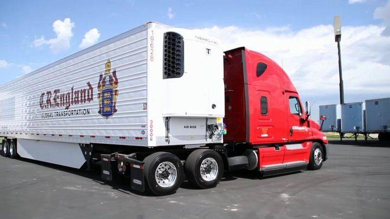

One thing to point out here, hinted at but not explicitly mentioned, is that the 53 foot trailer doesn't react to the orientation of the steering wheels, but to the orientation of the tractor wrt the triailer. The tractor has to be orientated to the left to make the rear end of the trailer move left. How to do so - turn the steering to the right to swing the tractor front to the left.
The fifth wheel is located right above the axle of the tractor, so one doesn't get the same more immediate angling by turning the steering ( as one would get with a hitch trailer). About 10 feet movement backwards is about right for the trailer to be noticeably orientated differently - and the rear might be now only 2 to 3 inches off from the line it was on before - probably about a 2 to 3 degree orientation of the trialer, depending upon the turning radius of the tractor - not really all that much of a reaction. Backing up another ten feet, with the same cranking of the steering, swings the cab out more, and the effect becomes much more noticable.
Ten feet is about one rotation of the tires, in other words the circumference of the tires. What better way to remember for the new driver how the trailer will react, and organizing his distance, and off-centre to the dock than putting it all in those terms. KISS has a workable outcome here.
Are we so sure the instructors are not saying that - ie that it takes one rotation of the tire to make, for the first 10 feet, to make a noticable effect, and it is getting misconstrued instead into "radius of the tire".
Really ?... interesting.[COLOR=#black]...[/COLOR]:oldwink:
https://en.wikipedia.org/wiki/Bullbar
http://www.herd.com/gallery/default.aspx?cmd=reset
Likes RonL

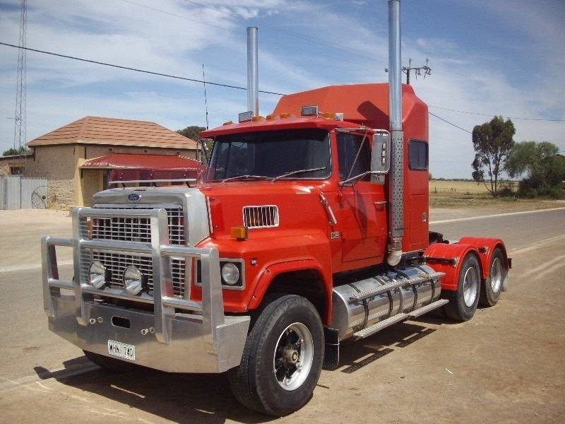

So now I have really embarrassed myself, that first picture is an over the road beauty, your picture made me remember my oilfield days, those pictures nudged my memory and that led me to remember "I actually own a 1966 Ford tandem axle truck with a brush guard" DUH! it has been a good weed killer for quite a few years:confused:o0):eek:o_O:nb):smile: used to have a cement mixer over the wheels:oops:
This one, right ?
Lol, just kidding... pretty, though, isn't it.[COLOR=#black]...[/COLOR]:ok:

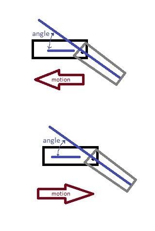

I agree with you on steering. But I do not see why the action-reaction lag should be any different. Actually your observation is very helpful to nudge this thread in the right direction. If the 10-ft rule does not apply to RR engines and RR cars then the only explanation for it to apply to tractors and trailers ("TT") must be because of steering. If steering cannot explain the rule for TT then the rule must be bogus.
  • #35
As far as I can see, the rule is followed by most TT combinations because the other dimensions are much the same, not surprisingly because they are probably near optimal. Overhang, wheelbases and positions of axles (and even the limits of the tractor steering, probably) will be what governs the locus of all the wheels.
