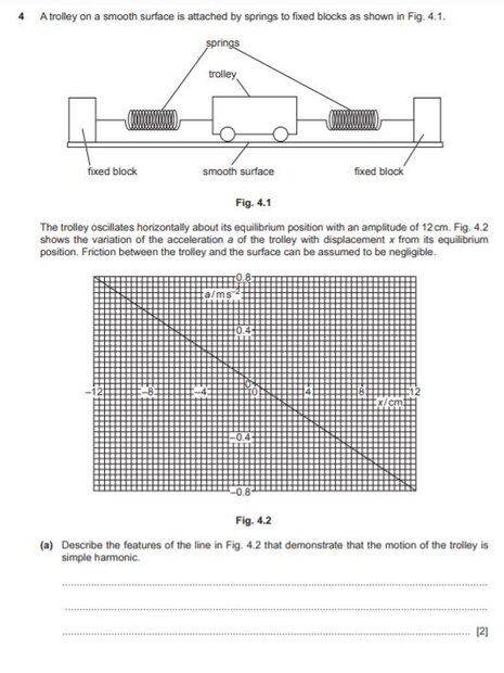

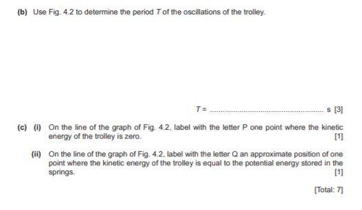

Help needed with part 4c.ii of the attached paper.
K.E. = 1/2mv^2 P.E = 1/2kx^2
How do I know the position where the K.E is equal to the P.E?

When they are equal, how does the PE compare with the maximum PE?
How does the PE vary with displacement?

Ok, so when the PE and KE are equal, how do they compare to their maxima?
They will be lower then the maxima when they are equal, it will be at some point between the max amplitude and the equilibrium position

Right, so each will be E/2.
The next step is to answer my second question in post #2. If the displacement is x and the effective spring constant is k, what is the PE?
