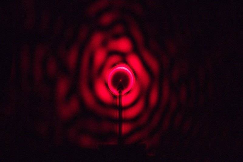

No need to guess. This has been done. See the following video by The Action Lab at the 5:45 and 7:00 marks.

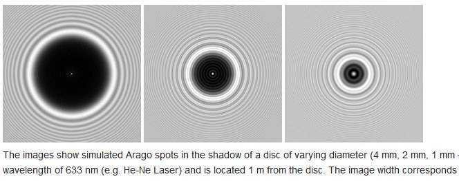

Hello Tech99.
Fresnel Spot:
1. Simulation
The image above shows a numerical simulation of the Fresnel spot in the shadow of a disk (diaphragm) with a diameter of 2 mm, at a distance of 1 m from the disk. The light source is a helium-neon laser which emits in the red (λ = 633 nm) and is located 1 m from the opaque circular obstacle. The actual width of this diffraction pattern is 16 mm. (Google traduction...)
2/Reality
Oups............
More difficult in the reality...

Bernadette
On the simulation, by enlarging the image I can see rings going right into the centre.
Hello Tech99.
You are rigth. For the simulation... Some other pictures.
