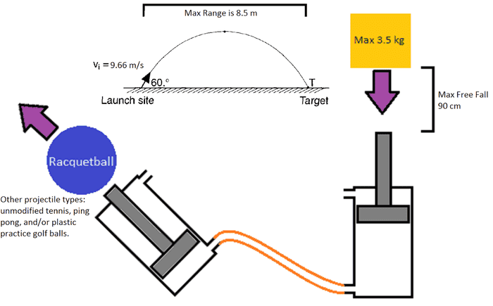

Hello my name is Aaron! I am a high school senior from northeastern Kentucky designing a pneumatic system of sorts for a science competition and need some help. I will be building a device that converts gravitational potential energy, from a falling mass, into air pressure (or possibly the movement of air depending on the design) to launch a projectile a specific distance (max distance needed is 8.25 m).
What I am thinking about doing is using one double action pneumatic cylinder (DAPC) as a bellow in which a falling mass (max 3.500 kg at a max 90 cm) would strike its piston shaft, creating positive pressure within the system. With that positive pressure another DAPC’s piston would simultaneously strike our projectile sending it airborne in theory. Below there is an illustration of my idea, sorry about the poor quality.
So what I need help determining is would this design work before I start buying parts? If so what approximate sizes should the two cylinders be and should they be different sizes to maximize the force exerted on the projectile? If you have any other ideas concerning the design or any questions about the project PLEASE feel free to share! Below are some of the design rules that pertain to this project along with some notes in italics about them. Thank you very much for your time in advance!

Yes I can. What I am really needing help with is determining the proper dimensions of the pistons. Should the bellow piston have a greater working volume than the striking piston? Should the bellow piston have a greater bore diameter than the striking piston? I am just trying to achieve the best transfer of energy from the falling mass, through a pneumatic system, to projectile. Thank you for your time!
Do they have to be separate devices connected by a small bore pipe? How about two pistons in one pipe - perhaps with a large bore flexible coupling pipe between them to reduce losses? Do you even need a piston in the launching side or could the projectile be the piston? Just some ideas to play with.
Thank you for the response! I was actually planning on using a large bore flexible coupling pipe between the two pistons. When you say could the projectile "be the piston" are you thinking about loading the projectile into a tube (somewhat like a potato gun) and having the pressure created from the bellow piston launch it?
Yes. Why accelerate (put energy into) the mass of a perhaps unnecessary piston.

It would be interesting to calculate the efficiency of the launcher. Calculate the available energy (the PE in the falling weight) and the energy in the projectile (idealy measure the launch velocity but you could calculate it from the range achieved and use KE=0.5mv^2). The ratio would give you the efficiency of the conversion.
