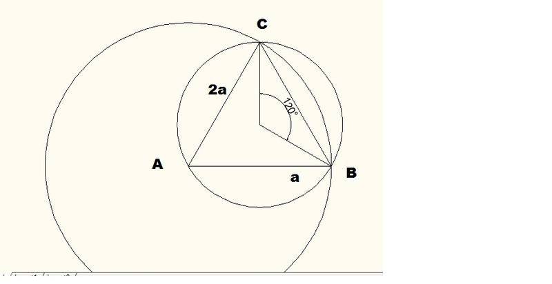

Based on my understanding of the question the diagram should be like this
ABC is an equilateral triangle with side 2a.Two circle are are drawn , with one of them crossing the points A,B and C.another circle crossess B and C with A as centre
Prove that the area enclosed by the two minor arcs BC are
(2a^2 / 9) x (3[itex]\sqrt{}3[/itex] - ∏)
Area of Segment of an Triangle
A= 1/2 a^2 (θ-sinθ)
Minor Arc Segment = Outer Segment - Inner Segment
Outer Segment
A=1/2 a^2 x (120 - sin120)
= (120-[itex]\sqrt{}3[/itex] / 2) a^2
Inner Segment
A=1/2 2a^2 x (60-sin60)
=(120-[itex]\sqrt{}3[/itex])a^2Note:Update the working Steps in tmr ,sleep now! is 3am !
I think you are supposed to use radians to measure the angles.
Yes. It doesn't matter for the "[itex]sin(\theta)[/itex]" of course, but it does for the first [itex]\theta[/itex] in "[itex]\theta- sin(\theta)[/itex]".
hmm thanks i think i got it
