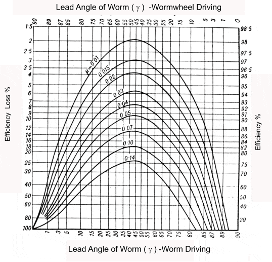

In general, worm drives will not backdrive. The friction prevents this.
What the backdriving of a worm has to do with centering a trolley is not fully evident.
I'm not a mechanical engineer but I played with Mechano a lot as a kid in the 1960s' if that counts! I never manage to back drive one of their worm gears but it can be done if the lead angle is high enough.
Google found this page
http://www.roymech.co.uk/Useful_Tables/Drive/Worm_Gears.html#SelfLock
which says..
Referring to the above graph , When the gear wheel is driving the curve points intersecting the zero efficiency line identify when the worm drive is self locking i.e the gear wheel cannot drive to worm. It is the moment when gearing cannot be moved using even the highest possible torque acting on the worm gear. The self-locking limit occurs when the worm lead angle ( γ ) equals atan (μ). (2o to 8o )

If that needs the worm to be back driven then +1 to what Dr D said. It's very unlikely unless the worm is designed for that. Usually people are concerned about accidentally back driving a worm which can happen unexpectedly especially when there is a lot of vibration.
I cannot imagine a high angle worm used in a power transmission application in the real world. In a toy, perhaps, but not likely in a trolley.
I agree.

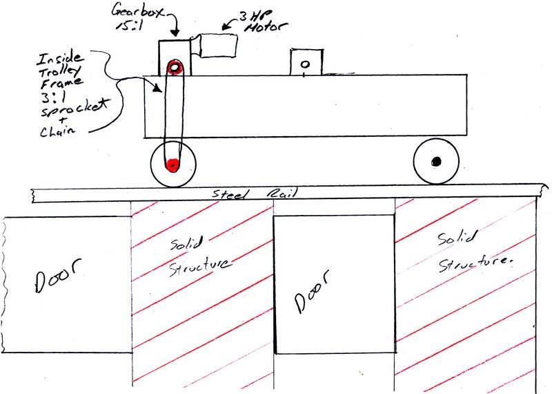

Well hopefully this will help. We are rebuilding this trolley as they call it that rides on a level structure that has a number of doors or gates as they call them. Currently they manually push the trolley over to the desired door, connect a cable to the gearbox in the center and raise the door. Now they want to install a 3HP motor and gearbox to move this trolley across the top of the structure since they already have power for the motor on the center gearbox. The gearbox sits on top of the trolley with the output shaft covered with a sheetmetal shroud and chain/sprocket combination is inside the structure of the trolley, so it is not actually exposed. The center gearbox is not being changed as they claim it works perfectly.
Now the gearbox manufacturer states that gearbox can be driven in either direction as long as it comes to a complete stop before changing directions. They also do not guarantee that their gearboxes will not not backdrive, as they say the condition always exists. However in this case we would want to be able to backdrive so the operator can have the center gearbox inline with the center of the door that they have to open and close. My drawing is probably over exaggerated.
Does this help explain what is trying to be achieved?

The trolley can be placed in approximately the right location over the door using the powered positioning drive but there is a problem in that the centre line of lift of the door lifting mechanism can be a little out of line with the ideal centreline of lift of the door .
The available means of achieving final alignment within required limits are :
Use the powered main positioning drive again but with better control .
Manually push the trolley along .
Couple the lifting chain regardless and allow the lateral component of the lifting force to pull the trolley into place .
Is this correct ?
That is correct Nidum.

Your worm and wheel gearbox won't backdrive in the circumstances that apply in this design so to move the trolley by hand or by pulling over with the lifting chain you are going to have to disconnect the drive somewhere . Could be done but likely to be an untidy and expensive solution .
Personally I would try educating the customer . A proper motor control system is going to be very much easier - and probably much cheaper - to implement .
