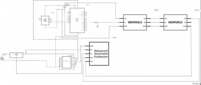

I am building a prototype of a balance indicator to prevent farm quadbike to roll on steep hills. I am using an arduino pro mini and 2 sets of assignable strips of 8 leds (https://www.adafruit.com/products/1426) and a gyro-accelerometer sensor. To power it, I am using the farm motor bike battery (12V). To switch the arduino on and off, I am using a momentary push button switch (NO, NC, C pins) and a JK flip flop ic (4027 dual jk flip flop cmos ic zc 4027). I have my 12V from the battery connected to the flip flop on vcc, j,k and the ground to vss,set and reset. My momentary switch give normally close ground to the clock pin and 12v when I press it. I use the flip flop as toggle mode with my switch as a clock. Next, from the ic, between the output Q and the ground, I have linked a 1F capacitor, my set of leds and the arduino in parallel. The capacitor is to prevent a damaging pike for the leds strip. I have tested it, I have the expected 12V after pressing once the switch and 0V after pressing it again. But when it is on 12V and the arduino and the leds should be running, the current is very low, too low to run the arduino and the leds. Could someone please help me ? I am lost. I am a student at high school very dedicated to my project. I have tried the device on the 12V battery without the switch and jk flip flop, it works fine.

I have tried my ic with a led and my momentary push button as a clock and it toggles as expected. I have a schematic here. I decided to add a voltage regulator.

I can't see what you are doing. (its too small to read any print). Is it possible you are connecting the flip flop output to the power pin of those chips?
There is no way it can drive much more than some more gates. If you want to switch power with the FF, you need to use a small p-channel power fet.
But, I'm still just guessing at this point.
Yes you are right, I didn't know that the flip flop output could not drive the chips. Thanks for this! I am new... Is a p-channel power fet similar to a transistor ? What is it exactly ? Thank you very much for your help.

The 1K in meBigGuy's schematic is the load. It is equivalent to the Arduino and led's in your schematic. You don't need anything in series. You will probably want a small capacitor (0.1uF or so) in parallel with the output of the FET if the wire from the FET to the load is long. Long being more 100mm or so. Pick a FET specified for a logic level gate and at least double your input voltage https://www.fairchildsemi.com/products/discretes/fets/mosfets/NDP6020P.html will work. The LED's should be powered from RAW not 5V as the Arduino has only 150mA total current capability.

Hello the switch story is not finished yet. It doesn't work sometimes. I think I am experiencing some switch bounce. Could you recommend me a component to overcome this problem ? What is hysteresis ? Thank you very much Bbruyne
There are multiple ways to debounce a switch, but the simplest is an RC circuit and a Schmidt-trigger gate.

Hello, I used a the set and reset imput of a second JK flip flop to avoid the bouncing of my switch. It is still not working properly. I was wondering if I need a pulse detector at the imput of the clock of the JK flip flop ? What do you think ? Thank you very much,
Benjamin
I guess you need to describe the circuit and symptoms a little better.
BTW, You need pullup resistors on the S and R pins so they do not float when the switch is open. 1K on each to VDD will be fine. (10K is probably fine also)
I would have expected you to connect one pole to JK-S and one pole to JK-R and the common of the switch and the JK clock to ground. The JK-Q then becomes the clock for the toggling JK.
If all that doesn't fix it, then It is possible that ground bounce or power supply noise is causing issues.
You need to have a 0.1uf ceramic bypass from VDD to GND on the JK's (very short leads) and the ground system also needs to be short straight wires.
The 2 JK's should have good ground connections to each other.
I'm assuming the S and R pins are actually SN and RN (low true) when I say you need pullup resistors. You are trying to emulate this with the JK flop:
If it is a REALLY terrible switch that bounces between NO and NC, then this circuit won't work and you need an RC and Schmidt trigger.

Here is how I finally did it! It works fine. Thanks a lot for your help. I learned a lot about a world that I didn't know about, electronics!

Glad it works. That was a good idea, using the JK SET/RESET like an RS latch for debounce. I'll probably end up using that at some point.
