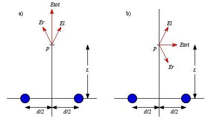

2) Also, that very commom problem of two charges, apart from a distance "d" when I need to find the Eletric Field in a midpoint between these two chages placed on z axis.
If the charges are +q and +q, I only consider the vertical component of the eletric field, but if the charges are +q and -q then I only consider the horizontal component. Why??
I don't understand why!

2) It's not clear in which way the charges are arranged. Please describe in terms of axis, not just vertical and horizontal.
2) At a point of interest, draw/sketch the electric field vector there due to each charge... then graphically add them.
I'm sorry. I made got this drawn below.
In "a" both charges are the same signal (positive) and in "b" one is positive and the other is negative. As shown in the figure, I don't understand why the total field is the way it is...
Like, in "a" we have "2q cosθ" because the said horizontal components cancel.
In "b" we have "2q sinθ" because the said vertical components cancel.
I don't even understand why in she second case "b" the Eletric Field points to where it is pointing...
***Never mind...I think I got it now. I was trying to do all in my mind but when I drawn I got it.

Can you add the vectors graphically (parallelogram rule)?
