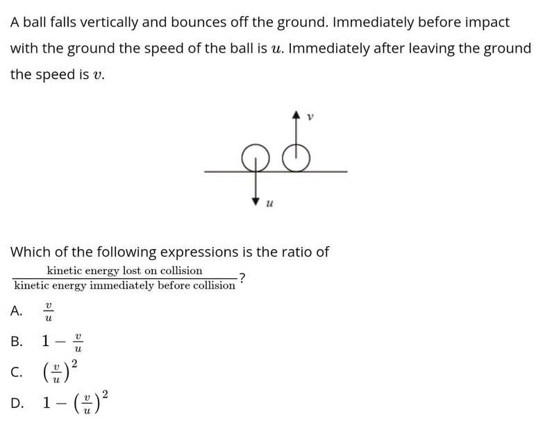

"A ball falls vertically and bounces off the ground. Immediately before impact with the ground, the speed of the ball is u. Immediately after leaving the ground the speed is v. Which of the following expressions is the ratio of (kinetic energy lost on collision/kinetic energy immediately after a collision)?

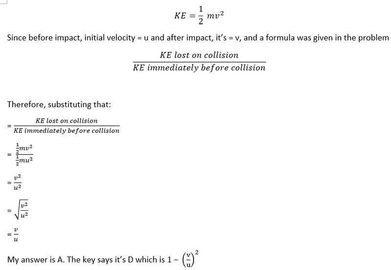

Here's my thinking:
  • KE is not a vector quantity, so it's always just written as is.
  • Velocity is a vector quantity, so taking into account that u moves downwards, I could show that as -u.
  • However, -u^2 is still |u^2|
  • Substituting from the ratio given in the problem, I could write this as (1/2mv^2)/(1/2mu^2)
  • That gives me a final answer of v^2/u^2.
  • I could square the whole thing and ultimately end up with the equation v/u, which is letter A.
  • The answer key says the answer is D. Why? What am I failing to include?
I'm including a picture of my attempt to work it out, just in case no one understood what I wrote above.

In terms of u and v, how much KE is lost in the collision?
Likes Iwanttolearnphysics
Is this supposed to be: (KEf-Kei after collision)/(KE before collision)?
If I do that and wrote (1/2mv^2-1/2mv^2) in the numerator, won't it just be zero?
Of course, that can't be the case, since it probably lost just a fraction of that KE. But how do I go about figuring that out? How do I figure out the fraction of KE it lost? What should I read to understand this problem better? Is this a momentum problem?
As for your question, in terms of u and v...? I don't understand how I can even answer that. :(
Look carefully at the question. You have to determine :
(KE before collision - KE after collision) / (KE before collision) .
The numerator is the lost energy. Factor m/2 cancels.

I got that. I think I applied the same thing in my solution. I just don't get where the 1- came from.
Likes haruspex
Separate the two terms in the numerator and simplify.
Thank you. It took me forever, but I finally got it! I appreciate it. That's all I was confused about. I guess I should have asked that straight out. I should work on my communication skills.

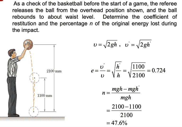

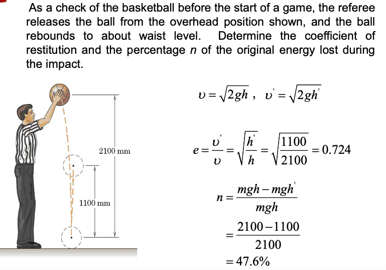

Here is an example of evaluation of the lost energy from the heights h and h’ :
This is a numerical example that can easily be calculated in a number of ways. It seems (see post #18) that OP's difficulty was matching one of the choices with what OP got. Translated in terms of the numerical example, it is the equivalent of failing to see that $$\frac{2100-1100}{2100}=1-\frac{11}{21}.$$
I agree. There is also something new in the example : ## v = \sqrt {2gh}## , and the equivalent for rebound. Furthermore there is the useful concept of coefficient of restitution, and its relation with changes of energy and heights h and and h’.
Thanks. I completely get this now. I'll be more careful next time. I haven't encountered a problem I don't know how to answer again so far, so I haven't been posting. But every day, I try to do at least 5. This forum is very helpful. Thank you everyone.
