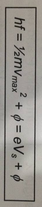

For this post, I'll be mainly referring to this photoelectric equation:
Fig 1: Photoelectric equation
1) Is 'e' the charge of an electron, ie. a negative value? Or just an elementary charge, ie. a positive value?

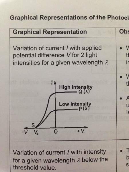

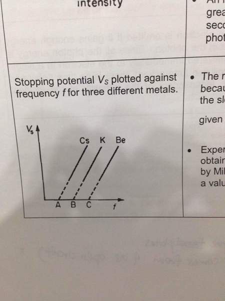

2) Is stopping potential (Vs) a positive or negative value? Because in my lecture notes, there's two different graphs, one saying that Vs is positive, and one saying that it's negative:
Fig 2: Current against Potential difference graph
Fig 3: Stopping potential vs Frequency graph

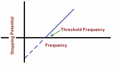

2) Googling 'stopping potential vs frequency graph' yields me almost similar results of this graph:
Fig 4: Stopping potential vs Frequency graph
Must threshold frequency necessarily be the x intercept? Can it be any higher value, like the one shown in Fig 3?
Hmm... it looks like an elementary charge, but that does not fit to the sketch later. Let's say it is the charge of an electron.
You can choose that in the experiment. The voltage where the current goes to zero is always "stopping" (the object where the light hits has a higher electric potential).
Yes. That is the minimal frequency where you get electrons out of the material.
