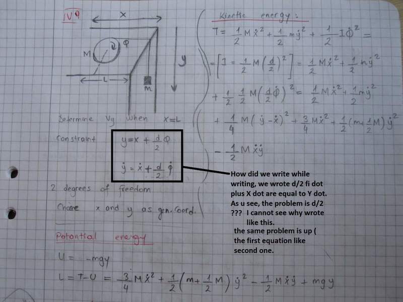

I have added a photo about my problem. My problem is why did we write while calculating constraint values as d/2. you will see on the picture what I am saying, I cannot see the reason of writing d/2
I guess from what I see, that [itex]d[/itex] is the diameter of the disc and [itex]\phi[/itex] is the angle the disc rotated. Then the radius of the disc would be [itex]d/2[/itex]. So the length of the string unwound will be radius times the angle rotated, or [itex]\frac{d}{2} \phi[/itex].
thank you for explaining :)
