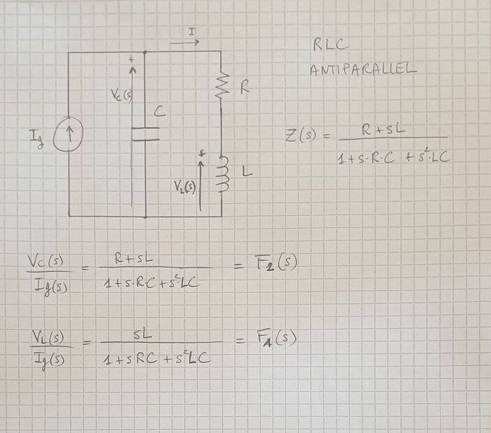

Look at the following antiparallel RLC circuit.
Take as input the source current ##I_g(s)## and the voltage across the inductor and that across the capacitor as outputs respectively.
Both transfer functions have the same poles, however ##F_1(s)## has one zero in ##s=0## while##F_2(s)## in ##s=-R/L##.
The calculation shows that ##F_1(j\omega)## is real (zero imaginary part) at angular frequency ##\omega_r=\sqrt {1/LC}## while ##F_2(j\omega)## at ##\sqrt {\frac {1} {LC} - \frac {R^2} {L^2} }##. Note that in the latter case the "resonance" doesn't exist at all whether the argument of square root is negative.
Therefore the bottom line is that doesn't exist an unique resonant frequency associated with a given circuit.
No surprise - F2 has a 1st-order lowpass characteristic (real at w=0 only).
Of course, there are circuits and/or functions which cannot show a resonance effect.

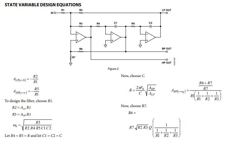

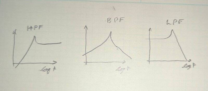

Also consider an active state variable filter circuit. This is a single circuit that will create a HPF, BPF, and LPF. Basically, by repeated integrations of the HPF. But it is one circuit (because of the essential negative feedback), with one resonance (for high Q designs). The magnitude of the transfer functions for large Q are sketched below.
https://ocw.mit.edu/courses/2-161-s.../cce7e9ece3e590e44b219324706e3de9_lpopamp.pdf
https://www.analog.com/media/en/training-seminars/tutorials/MT-223.pdf
https://www.ti.com/lit/an/sbfa002/sbfa002.pdf?ts=1726459820870
Sorry, I haven't been following the thread. How does that first stage accomplish a HPF function?
That's kind of my point. It is the whole circuit that you need to analyze. The feedback around two integrators creates a second order system. There isn't a starting point. Like a ring of integrators, maybe? I could have just as well said that it's derivatives of the LPF. It is a resonant circuit (if you choose high Q) that has, at different points, all three filter responses.

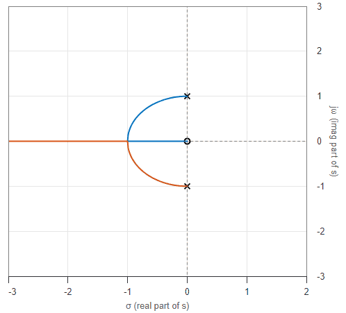

If this helps, it's a plot of a quadratic LPF pole locations as Q is varied. At Q=0,the poles are real at 0 and ∞. As Q is increased they move together and meet when Q=0.5 on the real axis at -ωo. Then they split into a conjugate pair each with a magnitude of ωo. At Q→∞ they get to the imaginary axis.
