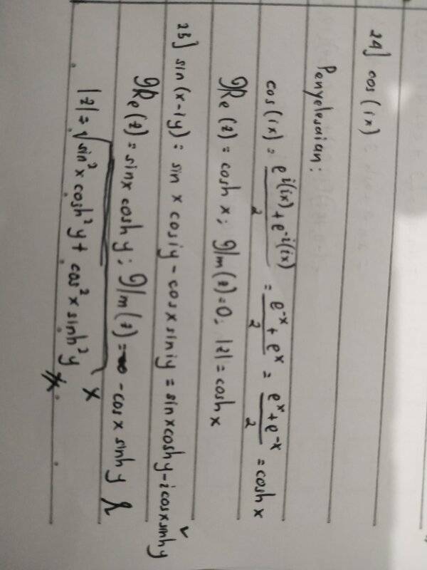

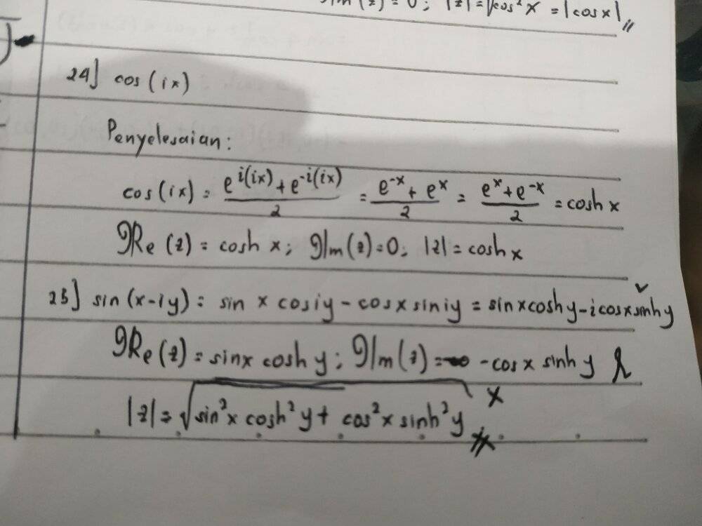

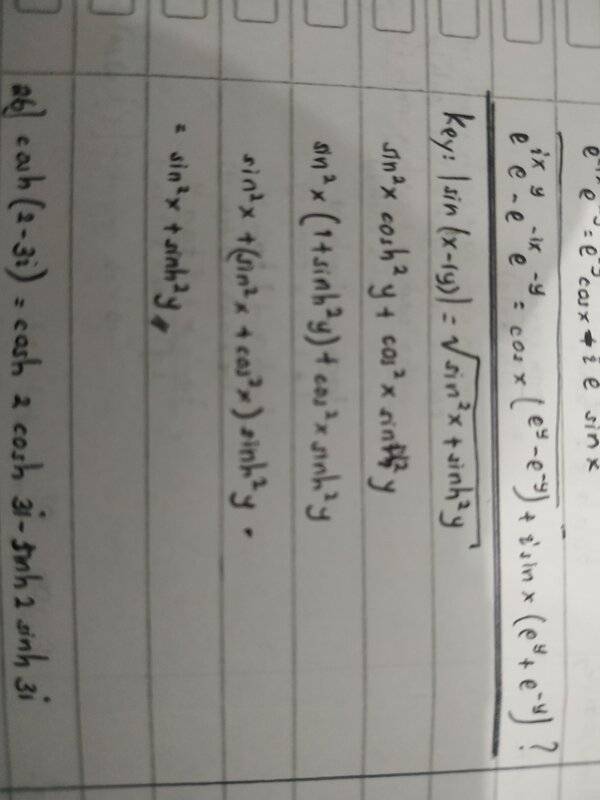

I mean ##cosh^2 y## at ##sin^x cosh^2y##
Please show your work. All of it.
That is some nice work and handwriting.
a nice identity in there
$$u^2(1+v^2)+(1-u^2)v^2=u^2+v^2$$
