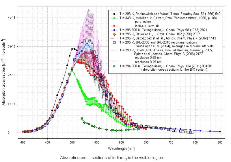

Why are absorption cross sections for atoms so much larger than that of molecules.
For example, the absorption cross section for the D2 line in Rubidium is ~1E-9 cm^2. Specifically, the cross section is basically σ~λ^2
The absorption cross sections for say, I2, is 9 orders of magnitude smaller! Briefly looking through many of the molecular spectra, all of the cross sections are on order of 10E-18 cm^2 to 10E-19 cm^2.
http://joseba.mpch-mainz.mpg.de/spe.../Halogens+mixed halogens/I2_400-800nm_lin.jpg
Does anyone know why the absorption cross section for molecular transitions are so much smaller than the atomic absorption cross section?

Note: if you want to compare crossections between atoms and molecules - you should compare like with like: i.e. H vs H2 rather than Ru with I2. I expect you'd get different results for Iodine crystals too.
Did you notice that the crossections increased for pure iodine when there was air in the sample (red)? Apart from that your graph shows only measured spectra for I2.
The lifetime of the excited state (usually a high order vibrational state which relaxes by non-radiative transfer) is orders of magnitude smaller than the radiative lifetime of atomic electronic levels which accounts for the difference in absorption cross section.
