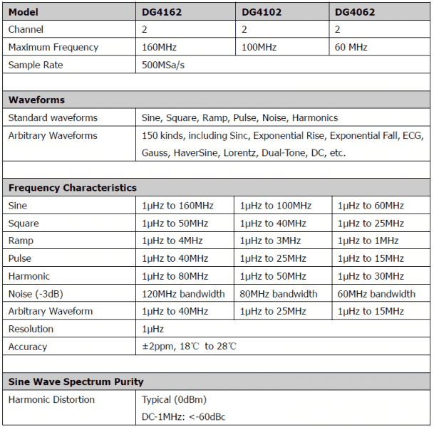

In summary, the Function Generator I am using (Rigol DG4162) can generate upto 50Mhz square wave, but with 1 uHz resolution.
I_am_learning
682
I checked some common commercial high-quality lab function generators and they seem to provide frequency output upto 50 Mhz (not a big deal), but with resolution of 1 uHz ! That means, they can generate signal with 50000000 Hz and also with 50000000.000001 Hz ?? That would equate to time-period difference of 4.00355*10^-22 seconds between those two signals! How can they possibly generate pulses with that high of time-resolution?
Any idea?

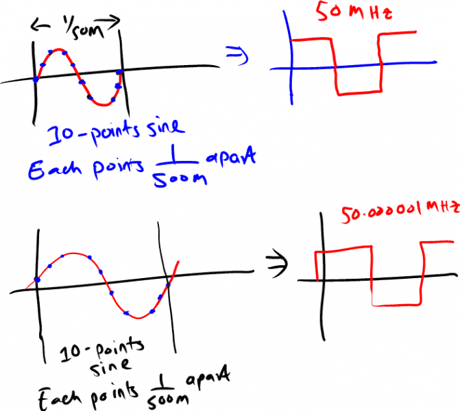

The Function Generator I am using (Rigol DG4162) has sampling frequency of 500Mhz and can generate upto 50Mhz square wave.
So, for example if I am generating an 50MHz square wave, you are saying that, the Generator first creates stepped 50 MHz sine wave (it must use 10-points to create the sine-wave, right? since the DDS clock frequency is 500Mhz). Oh, so, by using different values for the sine-wave, you can place the +ve and -ve half at different places. Aaha!
In the above figure, while creating the sine wave, each point is still created 1/500Mhz apart (since that's the max clock cycle of DDS), but by varying the Magnitude, we can create sinusoids (and hence square waves) of fine-tuned frequency.
So, does that mean, the frequency resolution is affected by the vertical resolution (i.e. how fine is you voltage levels)?
Also, its interesting that they allow upto 160 Mhz for sinusoids, but only upto 50Mhz for square waves? What might be the reason? If you can create sinusoid with 160 MHz, then just past it through a comparator and you have square wave with same res, no? Maybe because of the limitation of the comparator
