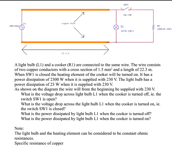

AC, 2 appliances in parallel, one of them is disconnected
In summary, the light bulb (L1) and cooker (R1) are connected to the same wire with two copper conductors of 1.5 mm2 and 22.3 m length. The heating element of the cooker has a power dissipation of 2300 W when supplied with 230 V, while the light bulb has a power dissipation of 23 W under the same conditions. The wire is supplied with 230 V and the questions asked are:a) What is the voltage drop across light bulb L1 when the cooker is turned off, ie. the switch SW1 is open?b) What is the voltage drop across the light bulb L1 when the cooker is turned on, ie. the switch
Moon_tm
A light bulb (L1) and a cooker (R1) are connected to the same wire. The wire consists
of two copper conductors with a cross section of 1.5 mm2 and a length of 22.3 m.
When SW1 is closed the heating element of the cooker will be turned on. It has a
power dissipation of 2300 W when it is supplied with 230 V. The light bulb has a
power dissipation of 23 W when it is supplied with 230 V.
As shown on the diagram the wire will from the beginning be supplied with 230 V.
switch SW1 is open?
the switch SW1 is closed?
c) What is the power dissipated by light bulb L1 when the cooker is turned off?
d) What is the power dissipated by light bulb L1 when the cooker is turned on?
Note:
The light bulb and the heating element can be considered to be constant ohmic
resistances.
Specific resistance of copper
+ on paper P=I^2*R and I=V/R --> R=V^2/P

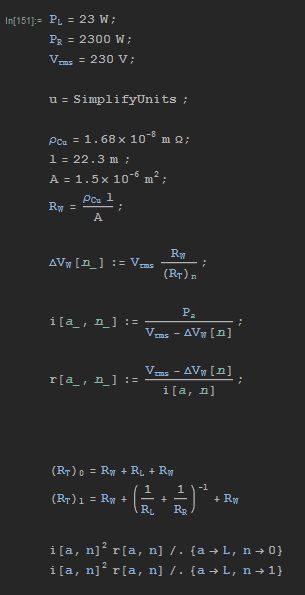

I can find out the resistance of the wire, but not the p.d. it produces, since I don't know the current (which is dependent upon how much Voltage is left after the first wire has been passed). Not even voltage division works, since the Resistance of the two appliances is dependent upon the current passing through them and that current is once again, dependent on just how much Voltage remains after the first wire...
Learning to use mathematica for physics:
Problem would produce recursion, since variables were interdependent - R_L and R_R on DV_W, which is dependent on R_Total (which is, wait, dependent on R values of the appliances, which depend on the current, which depends on the voltage left after the first wire...I'm lost, (in a recursive loop, just like tho Mathematica), please help. Need another perspective...
Edit: Now that I'm cooking lunch and thinking about it, V isn't limited to the given value V_rms, (V_max*sqrt(2)/2), so the the appliances could draw the P/V current...
That's not correct.
What can you say about the resistances of the cooker and the bulb? Can you find them from their ratings?

cnh1995 said:
That's not correct.
Can you explain why it is not correct? As I said, I'm kind of lost.
P/V = I
R=V/I
R=V^2/P
But doesn't this assume, that all of the 230Vrms gets to the cooker and the bulb? Or the rating is independent of the actual Voltage, that gets to them?
Yes, the ratings are based on the condition that the device is supplied at its rated voltage. For this reason you can find an equivalent resistance for the devices under the given assumption that they can be considered to be constant ohmic resistances.
