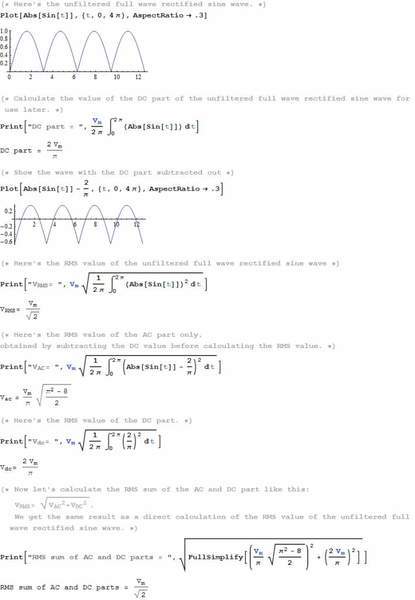

If the output of the full wave rectifier is filtered with a capacitor, then the AC component of voltage will be greatly reduced. If your book says that Pdc is the power delivered to the load, then there would seem to be an assumption that there is no Pac.
If the output of the full wave rectifier is not filtered, then there is a large AC component of voltage and you should introduce another term to avoid confusing yourself.
In the initial case of a pure sine wave, you should say Ptotal = Pac + Pdc. In this case Pdc is zero and the expression holds true.
For the output of a full wave rectifier, it's still true that Ptotal = Pac + Pdc, where Ptotal is the power delivered by the full wave rectified, unfiltered, sine wave. Since both sides of this expression are divided by the load R, you can eliminate that and just show that:
[itex]V_{rect} = \sqrt{V^{2}_{ac}+V^{2}_{dc}}[/itex] where [itex]V_{rect}[/itex] is the RMS value of the unfiltered full wave rectified sine wave, [itex]V_{ac}[/itex] is the RMS value of the AC part, and [itex]V_{dc}[/itex] is the RMS value of the DC part.
The RMS value of the unfiltered full wave rectified sine is the same as the RMS value of the sine wave input to the rectifier (assuming an ideal rectifier with no voltage drops in the diodes), so that:
[itex]V_{rect}=V_{rms}=\frac{V_{m}}{\sqrt{2}}[/itex]
Here are the calculations:
Thus the total power delivered to the load is the sum of the power delivered by the AC part and the power delivered by the DC part of the waveform.

Look at the first image of a full wave rectified sine wave in post #9. The DC comes from the operation of the rectifier. The negative going half waves of the input sine wave are flipped over, so the output of the rectifier only goes positive.
The average of a pure sine wave is zero, as you already know. But, after you full wave rectify it, the average is no longer zero. That's where Pdc comes from; that's why rectifiers are used, to make DC from AC.
medwatt said:
For any sinusoidal wave ##V_{ave}## and ##V_{dc}## are synonymous, are they not ?
If by the term "sinusoidal wave", you mean a pure sine wave with no DC offset, then yes, ##V_{ave}## and ##V_{dc}## are the same thing--they are zero.
In fact, ##V_{ave}## and ##V_{dc}## for any waveform would generally be considered to represent the same thing.
The output of a full wave rectifier is not sinusoidal. It is made of pieces of a sinusoidal waveform, but it's no longer a sinusoid after rectification. ##V_{ave}## and ##V_{dc}## of a full wave rectified waveform are still the same, but they're no longer zero. This DC part can deliver power to a load.
Look at the second image in post #9. That shows the full wave rectified sine wave with the DC part removed. That waveform has no DC part, and delivers no Pdc to a load. But, even though its average value is zero, it is not a sinusoidal waveform.
I showed how the output of a full wave rectifier fed with a pure sinusoid can be decomposed into an AC part and a DC part, and how the value of each part can be calculated.

What you care about is the ratio of DC output power to the AC power into the rectifier, and that number is expected to be less than 1.
As to where has the extra power gone--if the output of the rectifier is applied to a load resistor, without any filtering, then the extra power is the AC power out of the rectifier, and that power heats the resistor just as does the DC power. The DC power out is less than the AC power input to the rectifier by just the amount of the AC power out.
If there is filtering, the AC power in the rectifier output waveform is wasted heating the ESR of the filter capacitor, the diodes, the copper losses in the transformer, etc.

Forgive me for saying this, I don't think you understand my question. I am very aware of the fact that the "square of averages and the average of squares are not equal". No one is saying otherwise. What is confusing me is when the efficiency of the the rectifier was being calculated the author (of the power electronics book) divided ##P_{dc}## by ##P_{ac}## without justifying it where ##P_{dc}## used the average voltage of the sine wave and ##P_{ac}## used the rms value of the sine wave. The question is WHY ?? The prompted me to ask in my first post what is the power delivered to the load ? Is the power delivered calculated from the RMS value of the voltage or the average (dc) value of the voltage. My reason for asking that is because I've always known that the power delivered uses the RMS value.
When you say "##P_{dc}## used the average voltage of the sine wave" the problem is that the ##P_{dc}## is not calculated from a sine wave; it's calculated from the output of the rectifier, and that waveform is no longer a sine wave. It's the waveform shown in the first image of post #9, and it has a DC component, unlike a pure sine wave.
##P_{ac}## is the power delivered to the input of the rectifier and ##P_{dc}## is the DC component of power coming out of the rectifier.

That gives the wrong answer. As you have already observed, by asking ""where has the extra power gone ..."
Is that mistake actually showing up in bona-fide textbooks nowadays?sheesh...

**When in a lossless system they calculated different input and output powers you'd think they'd have gone back and figured out why they arrived at that impossible result.
Answer is of course in their [DC side] arithmetic they used product of average values not average value of products.
