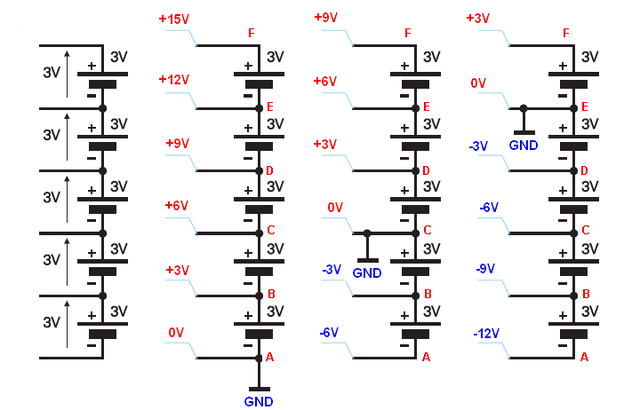

Your problem lays in fact that you do not understand what voltage is.
First the circuit with Battery, as you should know each battery has two metal terminals. One is marked positive (+), the other negative (-).
And to measure the voltage we need two point in the space. One of this point is treat as a reference point (GND). We have a very similar situation when we try to measure a height of an object. We need a reference point. The most common reference point is "above mean sea level". But when you measure the height of your kitchen table in your house you pick the floor as a your reference point.
Try read this
http://www.ittc.ku.edu/~jstiles/312/handouts/312_Introduction_package.pdf (start from page 3).
Here you have some examples
As you can see on the second example. If our ground is point A ( we connect the black test lead of a voltmeter to point A ) we can measure all the voltage in our circuit.
For example the voltage at point B is 3 volts higher than the voltage at point A. Voltage at point E is 12 volts higher than the voltage at point A.
But if we change the position of a ground in the circuit. For example to point C, we will have this situation:
Voltage at point B is negative because now the voltage at point B is minus 3 volts lower than the voltage at point B (GND).

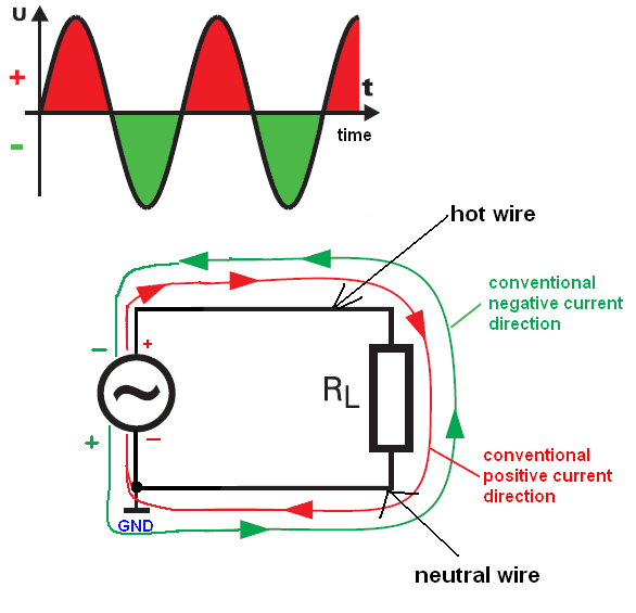

As for the AC current we simply measure all the voltage with respect to the neutral wire (neutral wire is our reference point).
And voltage continuously change his value. Form 0V to 120Vrms then from 120Vrms back to 0V. And again from 0V to -120Vrms and from -120Vrms back again to 0V. And start all over again, the wave repeats it self every 16.7ms/ 60Hz.

The current flows out of HOT and into NEUTRAL (through the load) while the voltage on HOT is POSITIVE. When the voltage on HOT momentarily goes to zero there is no current flow. Then, when the voltage on HOT goes negative the current flows out of NEUTRAL and into HOT (through the load). The current can flow into or out of NEUTRAL (through the load) depending on whether HOT is positive or negative voltage. The current can flow in either direction through the load. In almost all cases it doesn't matter to the load which way the current flows, which is why it can accept AC voltage directly, like a toaster or a filament light bulb. (we will skip the exceptions for now).
